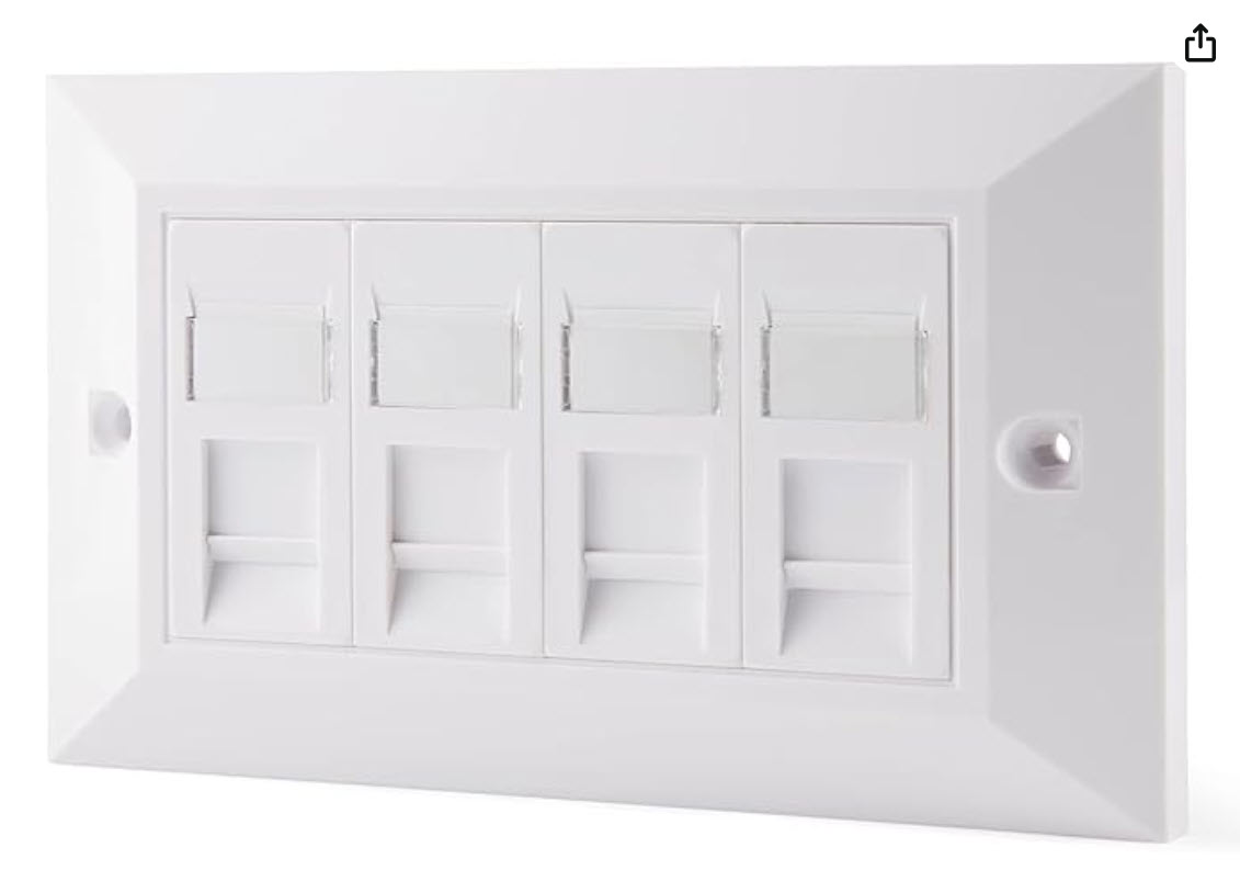

Hello,
I want to run 4 CAT6 ethernet cables to individual RJ45 wall outlets in 4 different rooms in my 1900's home.
Please can anyone recommend how to connect the four cables to my router hub in a neat/integrated fashion. I have BT Openreach entering the front of the house and plan to run the cables under floors and into the walls.
Do I just run the individual CAT6 cables to a 4 port RJ45 wall plate (similar to the image below) and connect each port to the back of the router (if I have enough router ports)?
Or, is there a better way to connect the 4 CAT6 cables together in a wall fixture near the router?
Many thanks for any advice.

If you have 4 ethernet ports and don't require them for any other purpose then yes it's simply 4 cables between the router and the socket.
Yes, using wall plates can be a neater and easier way of adding the network cables, especially if your not used to fitting the plugs on the end of these cables.
The wall plates with the use of a punch down tool can be quite easy, get yourself a simple ethernet tester too.
Then from the wall plates you can run further premade leads to the devices to connect and also to the hub.
However, if your running cables to each room it may be wise to throw in some extra cables and use a dual port in the rooms, then a switch (like an ethernet hub) near the router and a single lead from the switch to the router.
This way you will not be stuck when you find that you want more than 1 ethernet connection.

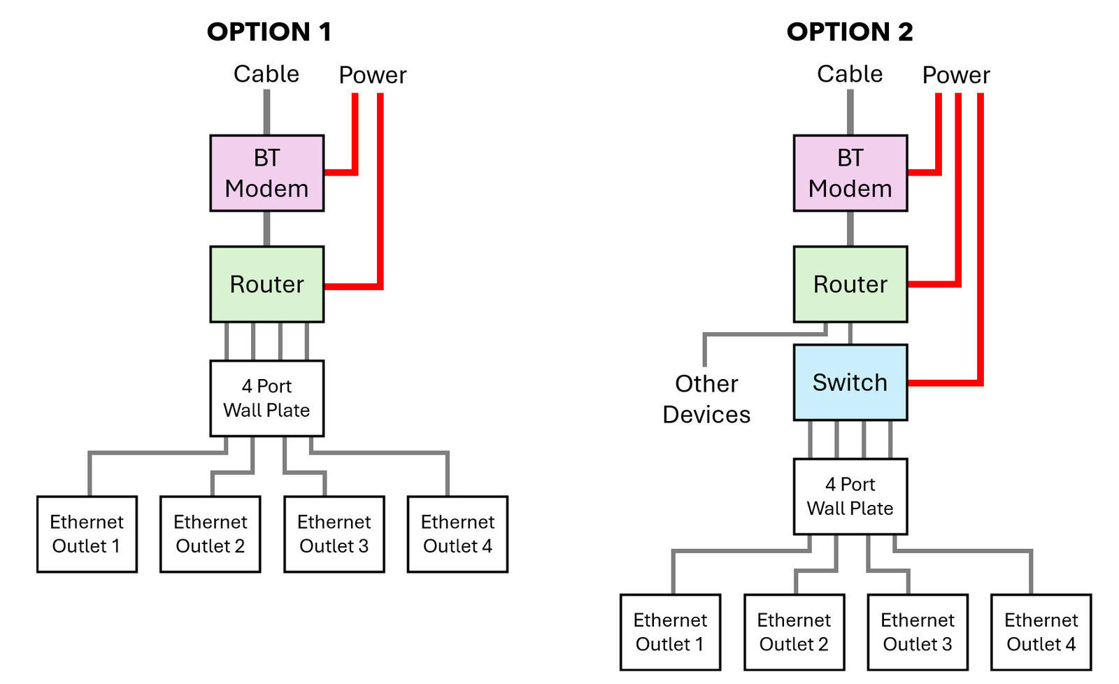

My current BT hub has 5 LAN, WAN & 2 phone ports
Many thanks for all your advice @ericmark, @SUNRAY,@mattylad and @FrodoOne!
So, are my basic options as below if I don't expand to dual port outlets?
For now, you may not "need" an additional "Switch", as in Option 2.
You can always add one later and "reconfigure".
Network Switches come in various sizes, usually starting at 5 "Ports" (1 In , 4 Out).

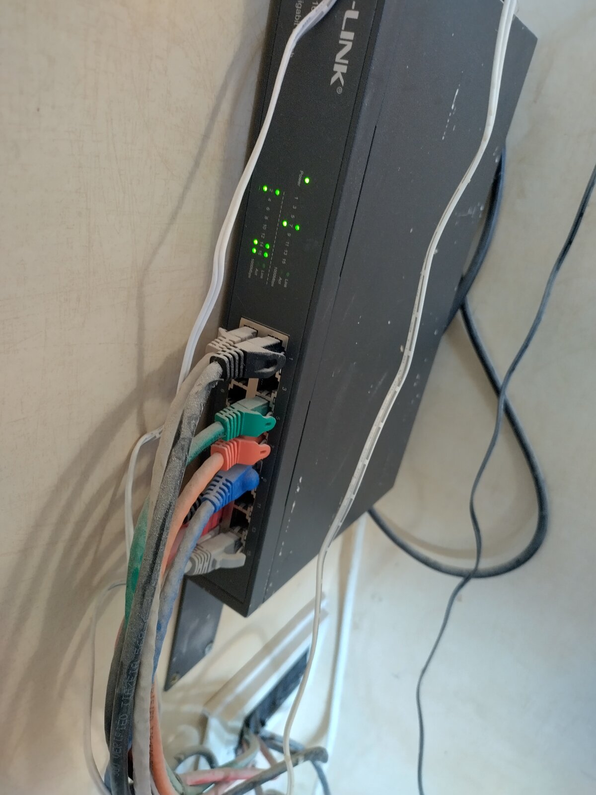

I have your option 2.
Modem...Router...Switch.
But from there cables go round the house. Some end in sockets, most others (TVs, PCs) just have the lead plugged straight into them.

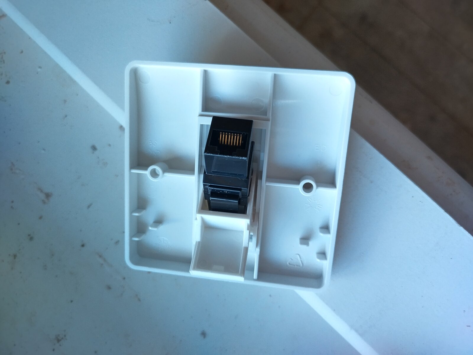

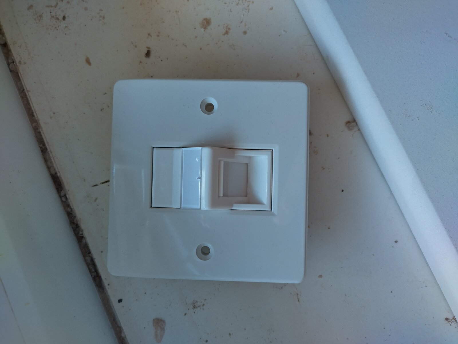

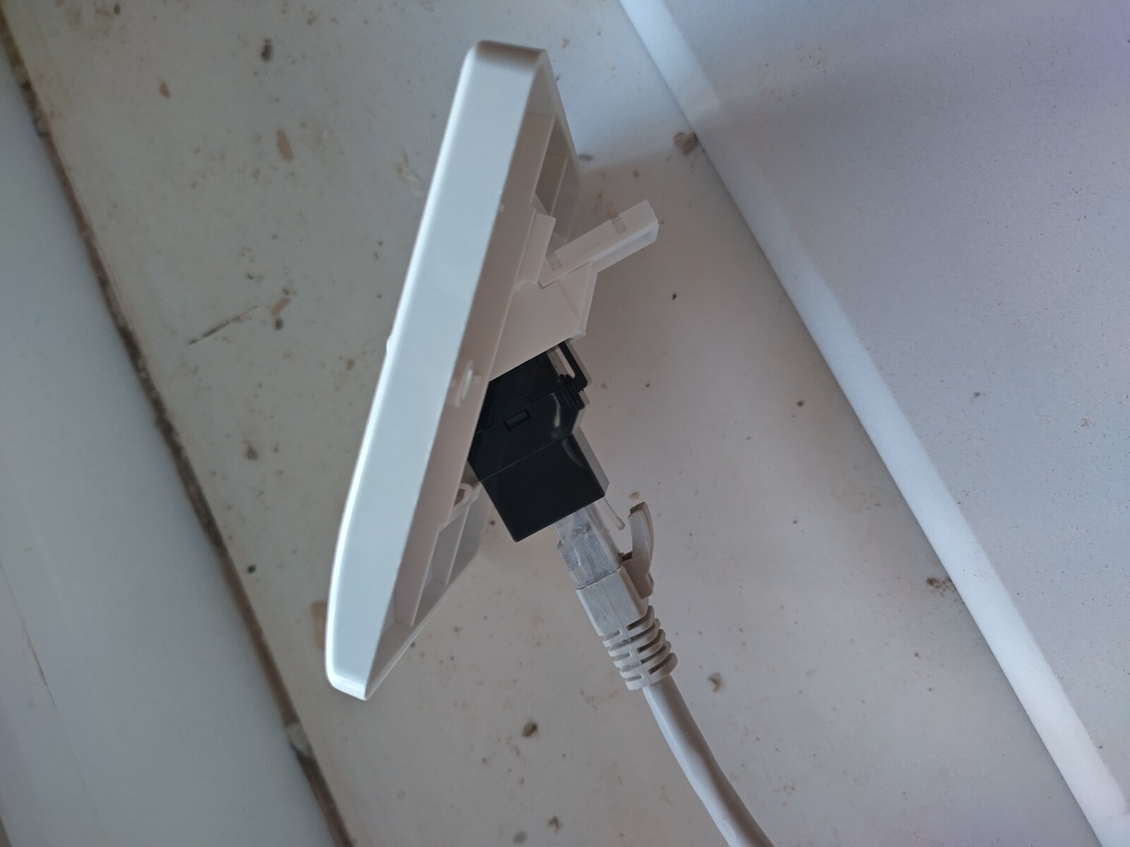

The last pictures are of an RJ45 outlet.
I know we have been told not to call them that, but even Cable Monkey (where I got the socket parts from) call them that.
There is a keystone coupler, which fits into front plate which in turn fits into a single Euro module faceplate, in this case, MK's LogicPlus.
