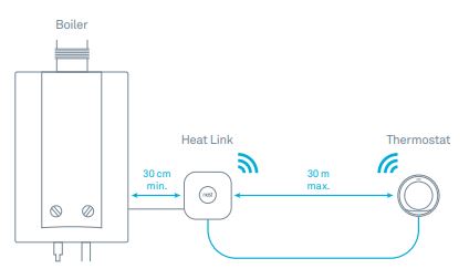

Reading the instruction on my Nest it seems the T1 and T2 terminals carry digital signals as well as power, it says in the readout wireless off so I would not run the 12 volt cables to any other box both thermostat and heat link pair.

This has come up before, but I suspect that this may have only applied to the original Nest product. But no one seems to have been able to get a definitive answer even from Nest. The newer versions have the possibility of being powered by USB in which case, there won't be any physical connection between the two units and Nest's own diagram for Gen 3 version suggests that when wired, there is still radio communication, a maximum distance between them to ensure a strong signal, and a minimum distance from the boiler so that the Heat link isn't screened from the radio signals because of it.

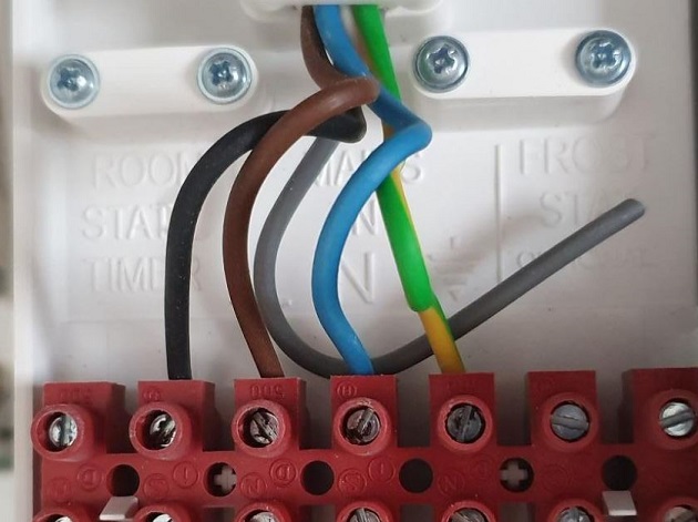

@stem - I have one boiler. The boiler has 3-core cable running from it to the junction box. The strands are brown, black and grey.
1. Should the grey cable from the boiler be the the one that we are referring to here as the Boiler Switched Live?
2. Should this grey boiler cable be connected to the two orange cables from the valve actuators?
3. Are those two orange cables from the valve actuators definitely the valve actuator switched lives?
4. What are the two grey cables coming from each of the valve actuators? How should they be connected?

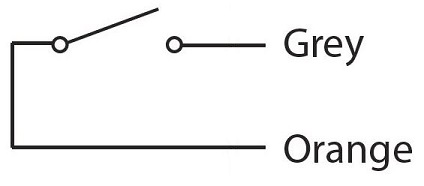

The dual zone valve actuators are Danfoss HPA2s - see manual here (PDF). The relevant wiring diagram is as follows:
According to your earlier photo below, the grey wire can't be the boiler switched live, it isn't connected to anything at the boiler end! The black wire is in the switched live terminal and would have originally been connected to the two motorised valve orange wires at the other end.
The boiler will require the following connections
1) A permanent live = Connects to L (Brown wire)
2) A switched live = Connects to the two orange wires from the motorised valves (Black wire)
3) A Neutral = Connects to N (Blue wire)
4) Earth
Yes
The grey wires should be connected to a permanent live supply. When the motorised valve opens this switch closes...
...which then makes the orange wire live, that then makes the boiler black wire live, and the boiler fires up.

It's still correct. Both grey wires need to be connected to a permanent live. It's the only way. Without it, there won't be a live supply for the valve to send to the boiler when the motorised valve winds fully open and operates the switch.
