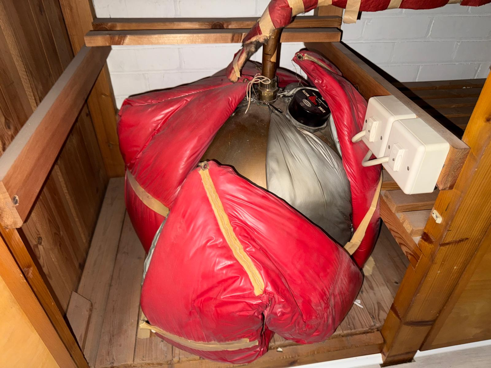

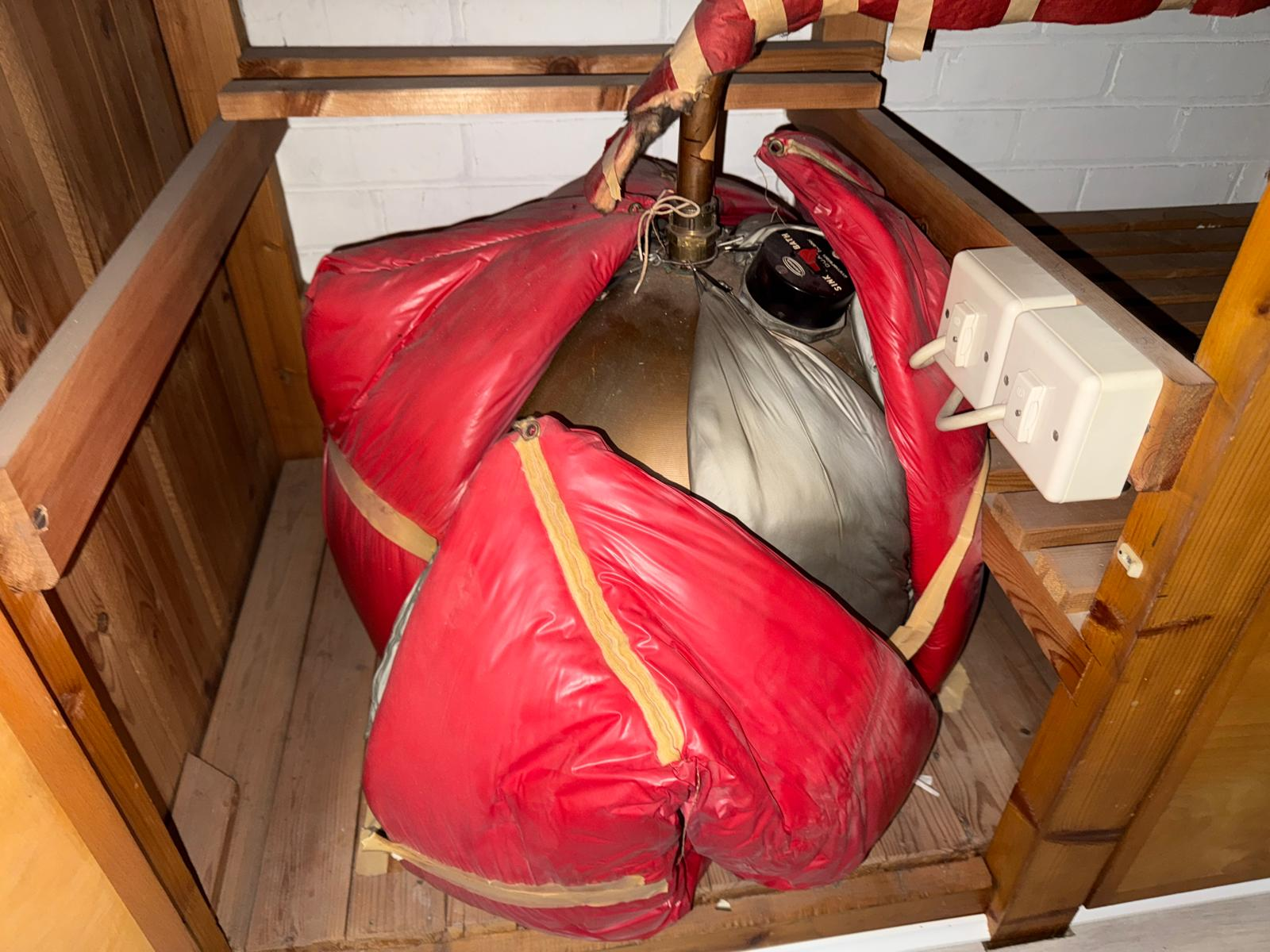

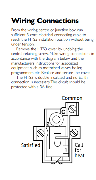

I need to control my water heating for the short term. I have a tank with an immersion heater that does not have a thermostat and runs 24/7 with the hot water at 75C . The heater is a dual element, each with it's own fused spur. Can I initially swap the fused spurs with these timers which will enable me to at least have it run for just a couple of hours per day?

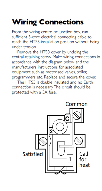

Further to that, can I add in this strap on stat into the mix so that I can also keep the water at 60C ?
If this is possible what should the wiring configuration be?
All immersion heaters have thermostats, including that one. It's located under the black cover.
If there was no thermostat, it would literally boil the water into steam and be exceptionally dangerous.
The cylinder thermostat is NOT suitable for an immersion heater as it is only rated for 3 amps - far less than the 13+ amps that the immersion heater uses.
The timer could be installed, but in addition to the existing fused connection unit, not as a replacement for it.
Thanks for the reply.... I was advised the same but there is no stat that I can see under that cover. I missed the 3A rating for the stat I was looking at.

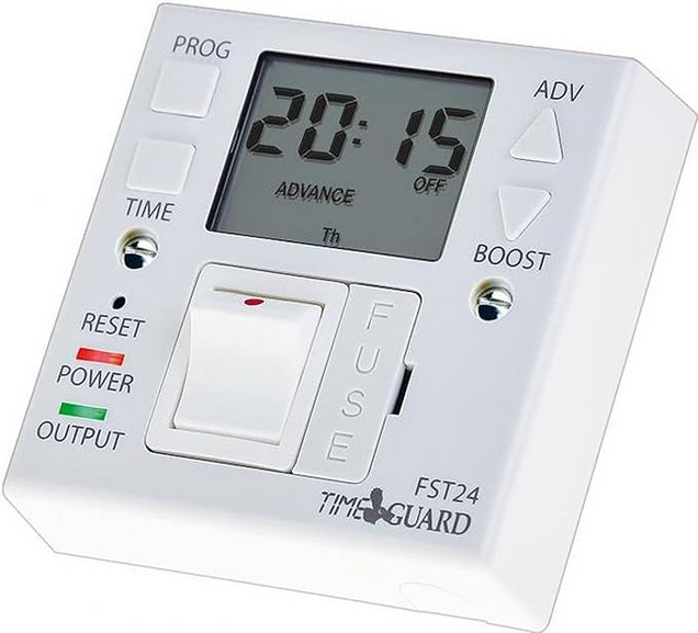

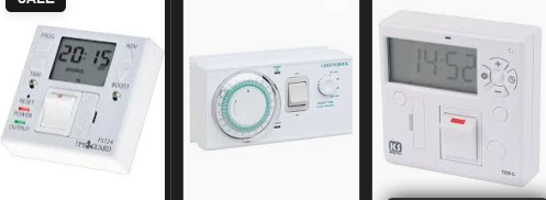

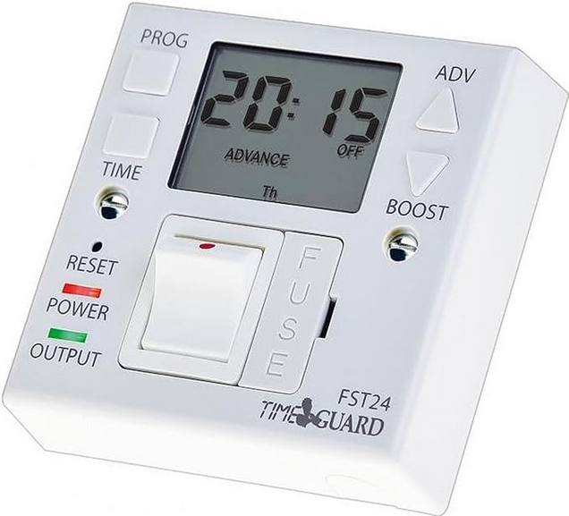

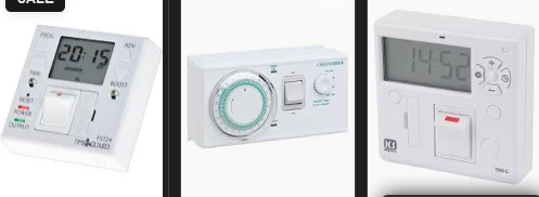

There are immersion heater timers designed for the job. 1732578100403.png Some have fuses built in, some can take duel supplies, the one I have does not run all the time at 3 kW designed for twin elements
although at around £300 this one is not designed for normal use, but for when one has solar panels. And I now realise was not really worth the money. However there are all sorts you can use.
That cylinder looks small, I would think it may just about fill a bath if you are adding cold, there are valves to mix hot and cold
you can't store hot under 60ºC and stop legionnaires and 60ºC is still too hot to put hands under it, so the mixer valve allows safe temp at taps and no legionnaires, and the water can be stored hot enough to fill a bath.
