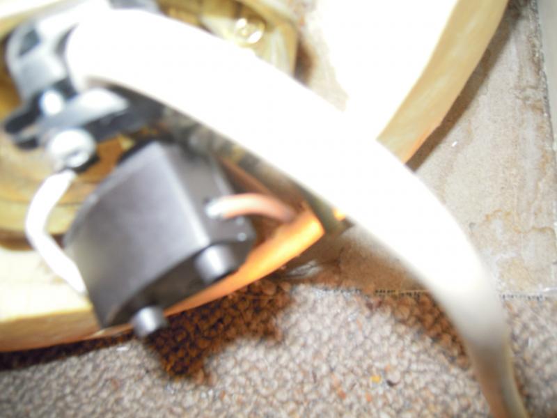

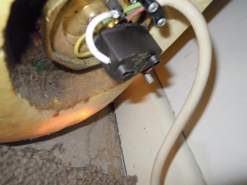

Assuming that the blue and green/yellow ('earth') are connected to the right places (we can't really see from your pic), that looks fine.
Dunno - it looks to me as if the thermostat is in the neutral.
Don't you think that it looks as if the brown wire is going into the RH stat terminal?
skye16: There seems to be some uncertainties being raised. Can you provide other photos, certainly one showing the right-hand side of the thermostat and, ideally, (if you can pull the stat out far enough), one showing us the connections behind the stat?

The heater is working fine. I changed the thermostat, by buying the same sized one from Screwfix. The only wires I touched were the brown and white ones, which I guessed were at the same sides as before. That is what I was unsure about.
All electrics in the flat were approved by someone last year, on behalf of the landlord - the stickers are still on. I just wanted confirmation that the brown and white wires were correct.
Thanks once again.
Images are in album thermostat 2 - not sure how to show them
Thanks for the advice. The heater is working fine. I changed the thermostat, by buying the same sized one from Screwfix. The only wires I touched were the brown and white ones, which I guessed were at the same sides as before. That is what I was unsure about.
That's what I suspected, and it is, indeed, fine. In fact, it doesn't matter which way around the thermostat is wired, so it wouldn't even have matter had you 'swapped the sides' of the two available wires.

I've just realised why the first picture looks odd; you actually have the thermostat the wrong way round.
The curved side matches the circumference of the element.
It doesn't matter as far as working is concerned but I'm not sure if it will contact anything with the cap on.
Good point - I hadn't noticed that. As you say, the only issue is whether the lid will fit on without touching anything - it would probably be worthwhile turning it around!
At the time, going by this photo, it looked like it was going directly to one end of the element.
