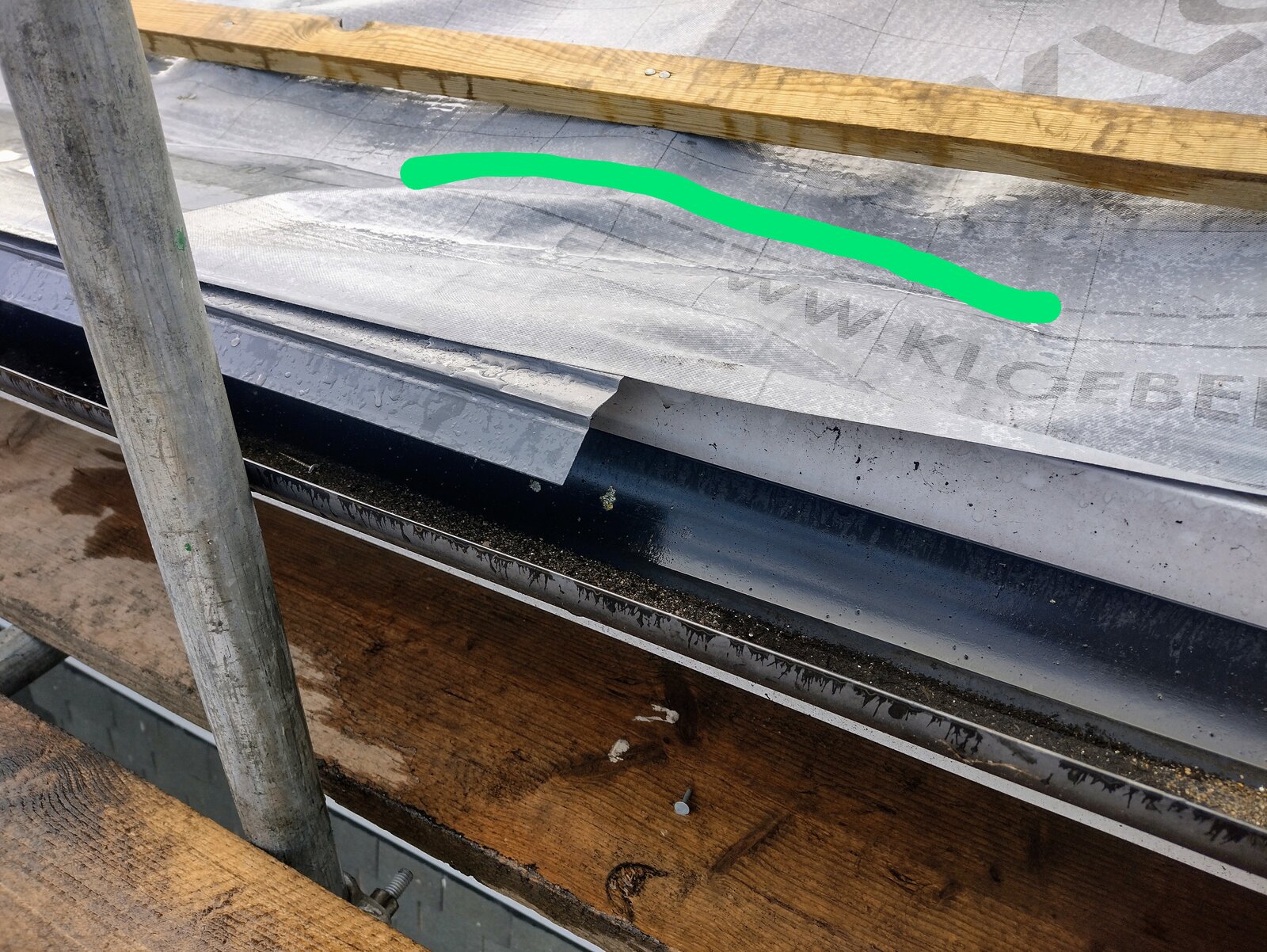

I have a problem with water pooling on the breathable membrane (marked on pic) and not flowing into the eaves support tray and into the gutter
Can I get some advise on what I need to do in order to correct this issue?
Potentially it seems like the UPVC Facia board is too high, so this could be preventing the slope.
The first course of tiles sits on the batten pictured and the end sits on the facia board.
The property is a mid-terrace, so I have neighbours on either side side with the tiles adjoined

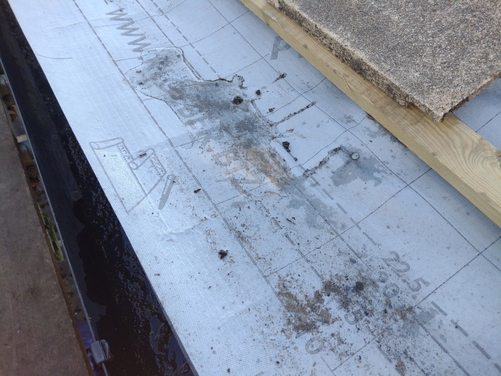

you could start by fitting the trays correctly.. nice underlay btw
I haven't nailed the eave support tray because with the 'dry run', I could see that that the water was not running to the gutter.
It just pools in the marked area.
What do I need to do to rectify this?
Thought you'd like the membrane, I believe I saw you recommend it.
try fitting one

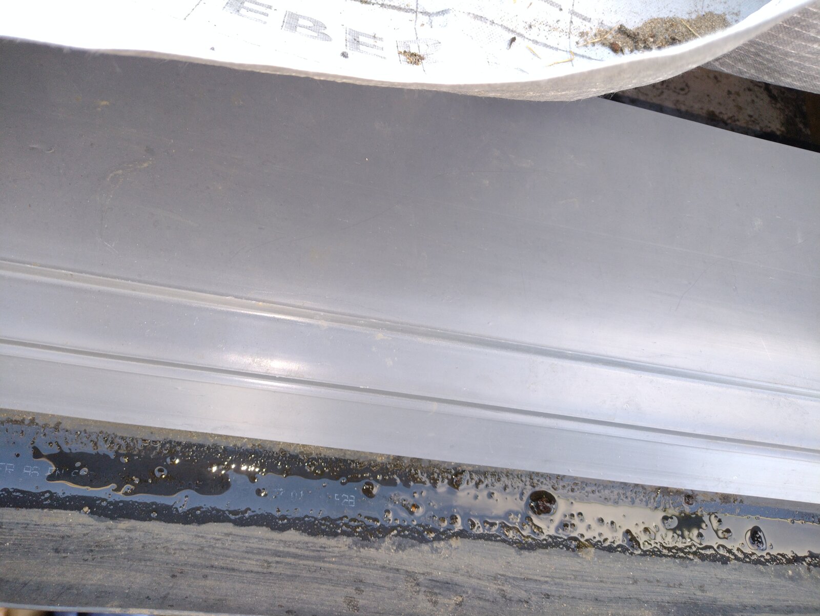

I fit the eave support tray and the water still pools.
What do i need to do?
The membrane will be cut back before installing the tile.

Is the eaves support tray a red herring - wouldn't the membrane pool water if just sitting on top of the fascia?
If so then the fascia is too high. Looks that way to me from that first photo.
On the other hand the membrane is only there as a last resort if rain gets blown under the tiles and what will happen is the membrane will pool until its deep enough to run off and with the tray support there is no chance of the pool dropping down int to soffit area
You need to use timber kickers on the side of the rafters to increase the angle at the eaves, and possibly noggins to hold the tray up in-between the rafters.

Lowering the fascia board would definitely help provide an adequate fall for water to run off.
To lower the fascia would you remove the gutter and replace the UPVC fascia (for one not as tall) or would you use something like an multi-tool to cut it?

I've sliced 10mm off a fascia with a multitool, needs slow speed or it melts and re-sticks. Took about 10 minutes to do 5m. Tack a batten on as a guide.
You need to be careful lowering the fascia as the bottom row of tiles will "droop". I've seen quite a few like this, presumably non roofers encountering what you have, but I doubt a carefully judged amount would be an issue.
Kickers sounds like a better idea than cutting it.
Lots of roofs are like this, where the bottom few rows of tiles are at a shallower angle.
It depends what the rest of it looks like.
