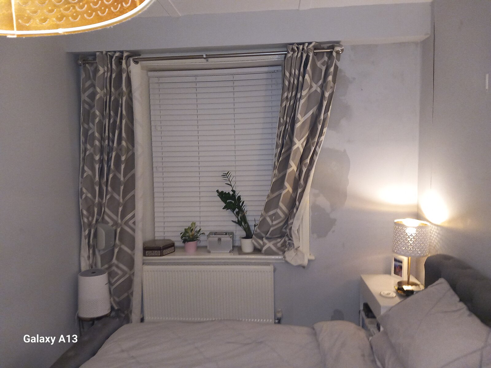

How to deal with wet plasterboard?
‘Mate who wants a quick solution. Baton and cladding?’
Batoning and cladding isn’t a ‘quick solution’ it is a cowboy way to go about it. There is clearly water ingress coming from outside so it’s either faulty guttering, outlet, pointing, flashing, window seals or a roof problem.
He knows but no one's going to do anything about it and building will be knocked down anyhow
I agree that you need to fix the problem first. However, if that's not going to happen, here's an idea: affix a wall-mounted radiator / towel-rail / heater to that section of the wall and run it 24/7. It will dry out the damp plasterboard.
Sure, it's going to steadily rotting-away behind but at least it won't show in the room.
Be aware though that that water has to go somewhere as it dries and so also, a dehumidifier needed.
Edit: be mindful of the close-proximity of the curtain. It could overheat any heater placed nearby.
Plug in heater?
Remove rad and skirting, get some of the least "bathroom like" t&g pvc panels, glue them on with no nails, seal the joint at the floor the best you can with silicone and refit the skirting. Should buy a bit of time.
Have to remove rad? It's only wet to right of window. Would that work just to right of window? Going over lining paper too. Baton and screw?

That looks awesome. Do you think I could get away with applying it just to the area to the right of the window and make it look normal?That's where the majority of damp is. Tiny bit of damp on wall next to it where lining paper is coming off
Patching bits may work, but it's likely to come round the edges, if the source is ongoing and increasing neglect of the building fabric elsewhere then it's a big gamble - once it's let your landlord friend will have lots of legal obligations to the tenant, eg hotel accommodation if it becomes uninhabitable.

Your picture of the outside is not the same window as shown internally with the damp. Can you stand back from the building and take a wider-view pic, hi-lighting which window we are talking about.
Edit: unless it is the window with the light on in the pic, above the canopy?
If this is the case, jump up on to the canopy and see what's going on. You may find that it's something as simply as being covered in moss and the water not draining away or, the flashing coming away etc. Take some pics and post on here.

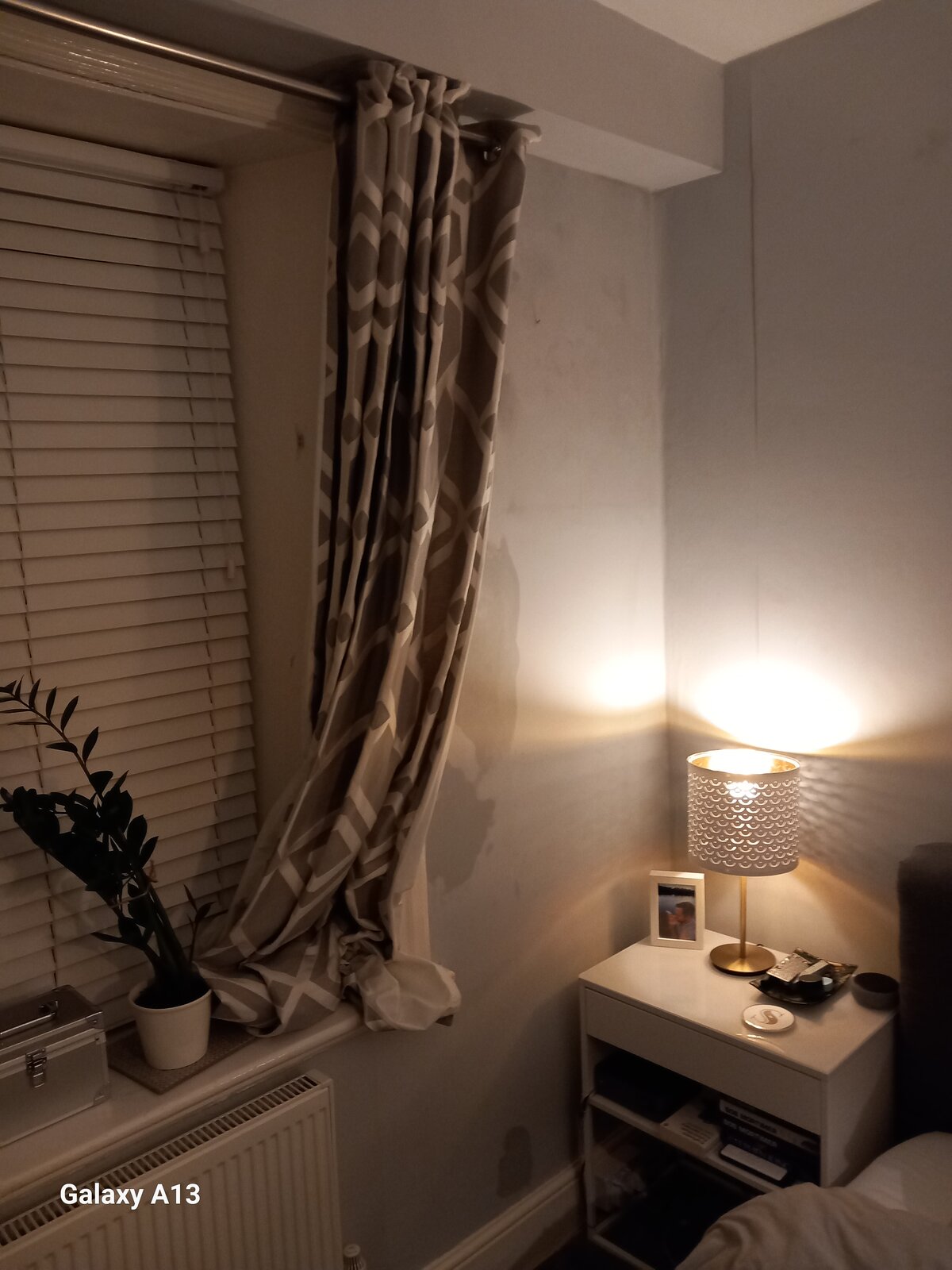

You've got a pretty serious damp issue. It is not just the window wall but has also migrated into the adjacent one, seen by the paper coming off.
Regarding applying the wallrock. Would you need to strip off the old lining paper then sugar soap and clean the old paste off then apply new super paste? Would lining paper then be applied on top of that?
Regarding outside it's below balcony in basement and he's adamant nothing more can be done. Try and find more photos
Ah, the detail is starting to come out now.
Basement, so basically it's coming through the walls and so yes, the solution is to tank it.
I think the best bet is, re-house current tenant and leave empty. He (Landlord) needs to accept that maybe he's f*cked up and the room is not fit for habitation.
Put it this way, would you house your daughter in that room, irrespective of the rent rate? I know my answer.

'Tanking' is as it says, creating a sealed 'tank'. Think of a swimming pool except here, you're trying to stop water coming in rather than leaking out.
Basically, remove everything back to brick; seal and start again, re-plaster, re-decorate and re-furnish.
https://www.newtonwaterproofing.co....also known as,to make the basement watertight.
You must, must, must have ventilation and personally, I'd also include a secondary means of escape (not sure of the rules on this).
Well he's obviously thought of all this. Shall put the lining paper (foil backed on that corner where the damp is coming through),shall I bring it around the corner a bit too?
