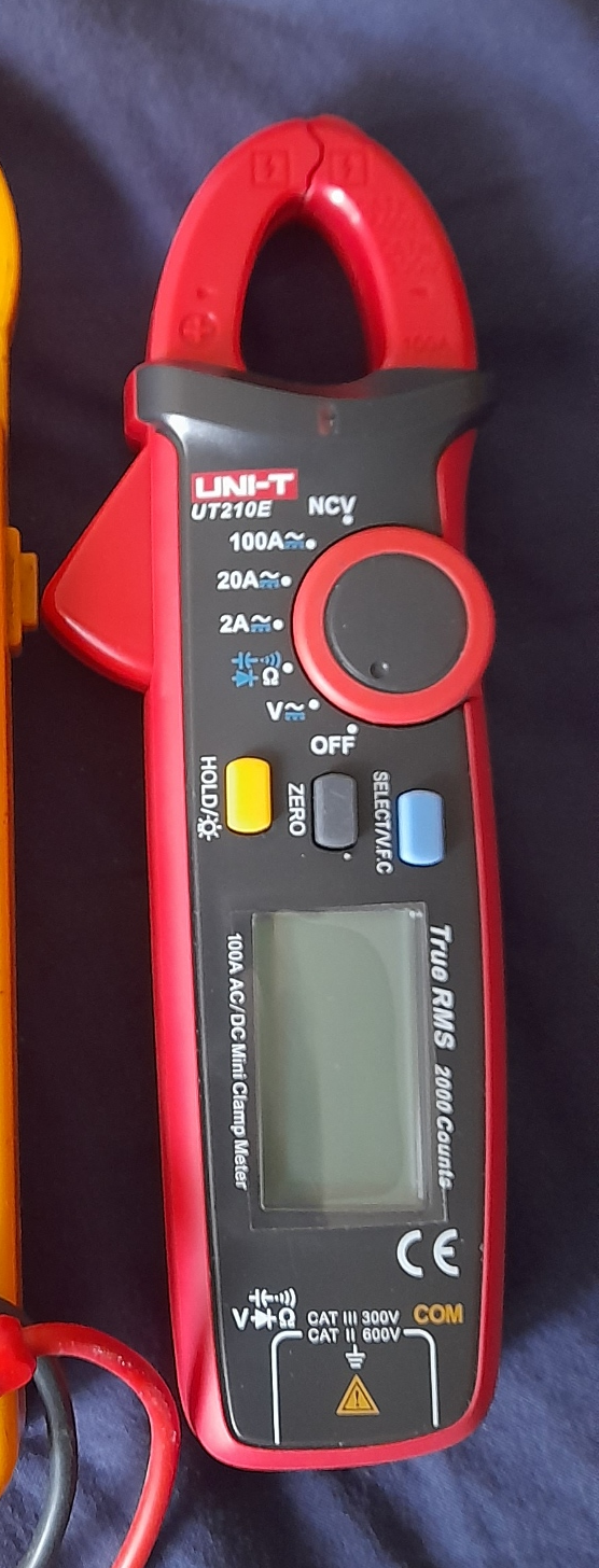

A standard ceiling rose has three sets of terminals plus an earth clamp. Out of interest I held my own tester 1664022074654.png at ceiling rose with switch off, and it beeped and the red LED lit to show power at the ceiling rose without removing the ceiling rose cover, same with switch, as to if cheaper testers will can't say.
But be it a neon screwdriver or a full blown multi meter as shown, you do need a tester, so I will start with neon screwdriver, which should show centre block of three as being live, with switch on or off, and with switch on the block of two should show live, but a neon screwdriver can not test the neutral, however if you know you have a live, then a wired multi meter will then show if you have a neutral.

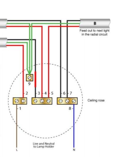

The ceiling rose should look some thing like this
L is line to lamp, LL is line loop, N is neutral and E is earth. Even with switch off LL should be live, what the switch does is connect LL to L, This is the basic wiring for three switches the right hand of the three loops is what goes from ceiling rose to switches, i.e. just two wires, the loops show what wires are in each cable.
So with power off, a link L to LL then turn power back on, and lights should work, switches will do nothing, but it proves the light. Once sure light is OK then we go further, but prove the light works first.

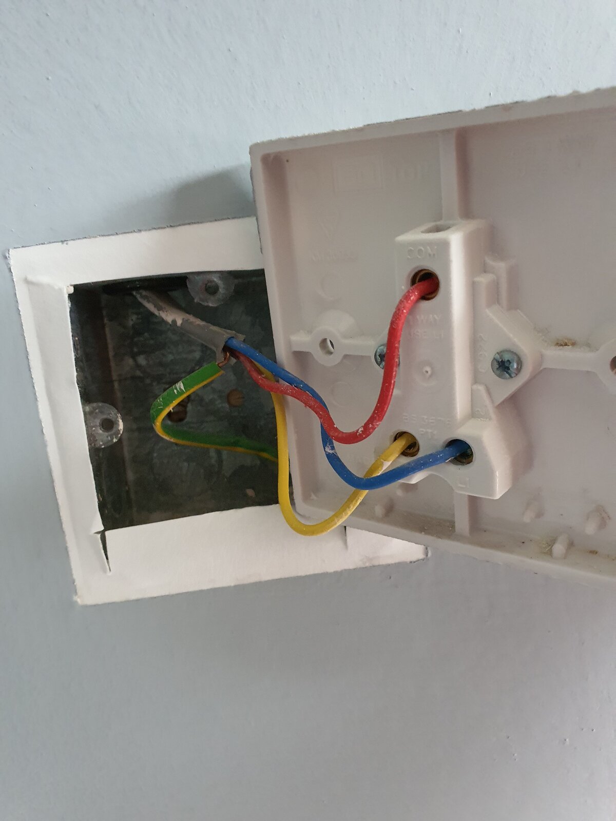

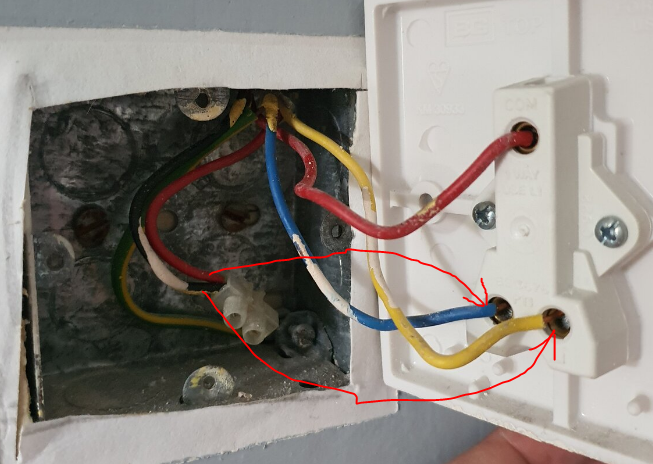

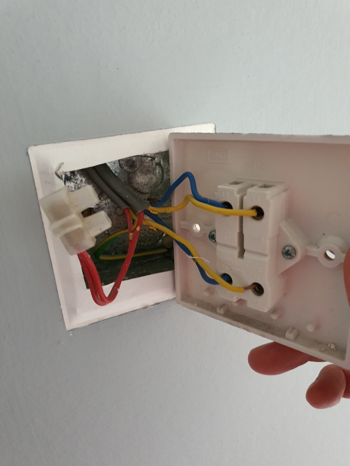

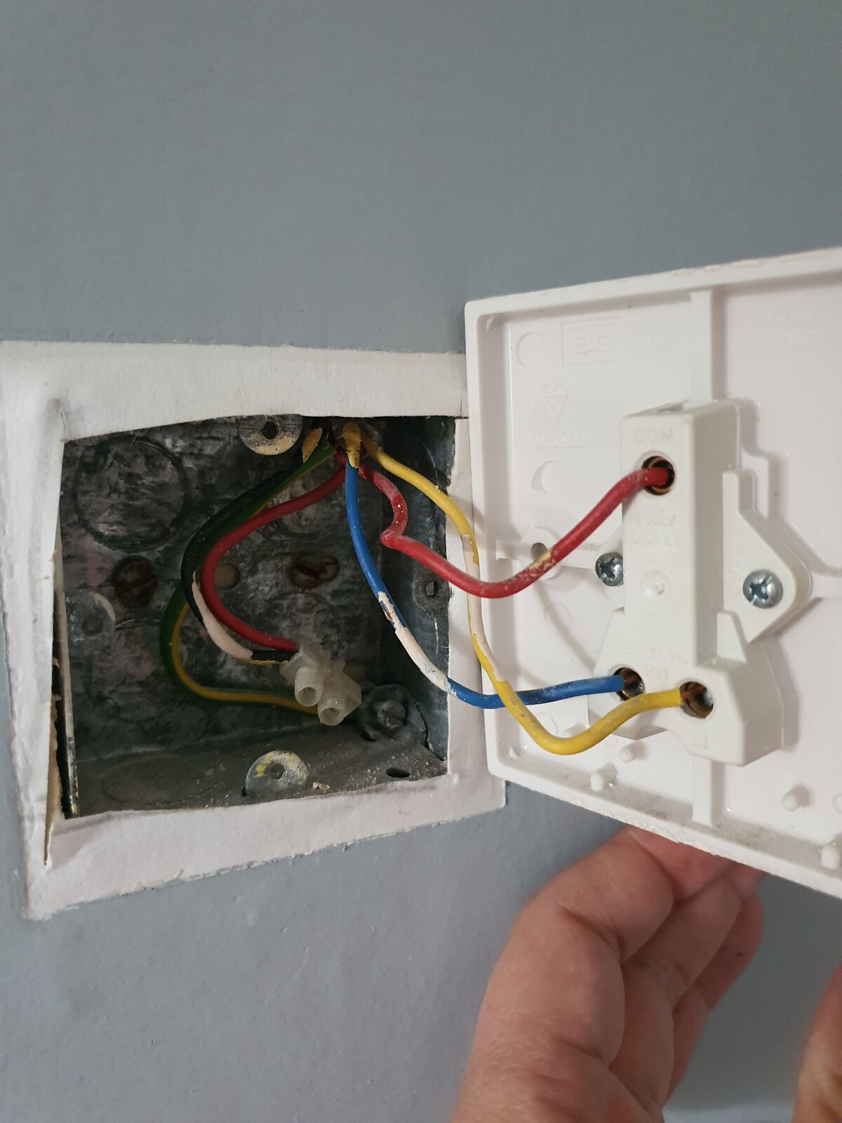

Here’s some photos of the back of the switches. I’ll open up the ceiling rose again and take photo, but it was the same as the diagram attached that I found online.
I was testing with a decent enough Fluke. I’m confusing myself where I tested from now…which points should I test across? Testing across COM and L1 when the switch is on, I read 135VAC. Across COM and L2 when the switch is off, I read 205VAC.

I think you need to download diagram of intermediate switching and do as I did. With the power off do a continuity test. Unless you have 5m leads on your multimeter, you will been longer cables, as I said, used alarm cable, I had 30m siting at home and it is very light. I screwed one strand of the alarm cable in to a terminal on the ceiling rose, ran that cable down to the switch, wrapped it around one of the meter probes and then touched each of the cables in the switches with the other probe (after I removed the face plates).
Checking for voltages doesn't help that much if someone has messed up the commons.
BTW, I am not an electrician and have never previously worked on two way lighting, but thanks to the electricians here and the widely available images on the web, I was able to identify each cable and fix things. You really do need to use continuity tests with the power turned off sand the switch plates removed to help you draw your diagram and see if the existing set up is correct.
From that point you can then start to look at other things.
You are getting some strange values there, probably due to the type of lamp in the ceiling lamp holder.
Those switch back boxes appear to be properly earthed, I would suggest making all your measurements with reference to the earth. In other words connect one probe always to the earth terminal, and repeat your testing. You can expect to see perhaps a few volts even when a wire is not live <50v and >230v when live.

Assuming the earth is properly connected all round, no need for any long wires, he can use the earth terminals instead for his continuity tests.

Show us a pic of the wiring at the ceiling light . You should do some testing there . Voltages between...
Permanent live ( if present) to earth.
Permanent live to neutral.
Switched live to earth
Switched live to neutral.
Tell us the results.
