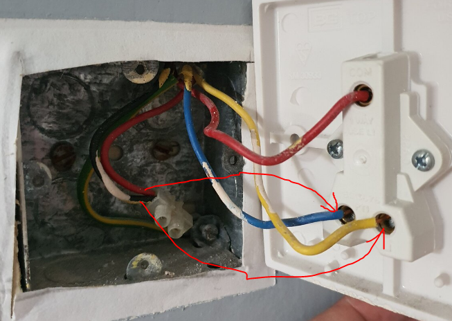

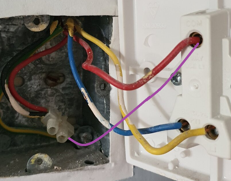

My first test would be to measure the voltage between the 2 reds and flick switches. it should be 230V at some time.
Without a meter i'd link the 2 reds, either with a link wire (shown purple) or move the single red into the choc bloc. Either should put the light on when power is restored. If that doesn't happen thenthe fault is not in the switches.

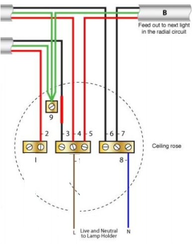

The next check is to move the brown in the ceiing rose:
That should put the light on when power is restored. If not you eoither have no power coming to the rose ore you have a faulty bulbholder or bulb.
