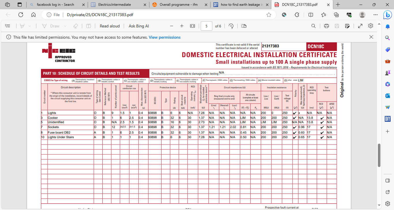

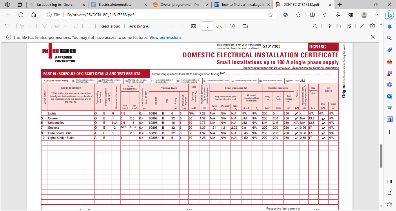

Has he given you an EIC with his test results ?
he recommended to rewire the light circuit which I believe is an over kill. all I need to do is to find that piece of wire and replace it whether is the main feed (from ross to ross) or from switch to ross. but I need to know where to start. I have a multi meter
do you mean this one "DOMESTIC ELECTRICAL INSTALLATION CERTIFICATE"
You need competence and test kit that does insulation resistance for staters
What about the certificate ?
yes i do, here it is

Interesting.
No Zs for the lighting circuit. Why not ?
Also LIM for the cooker - why?

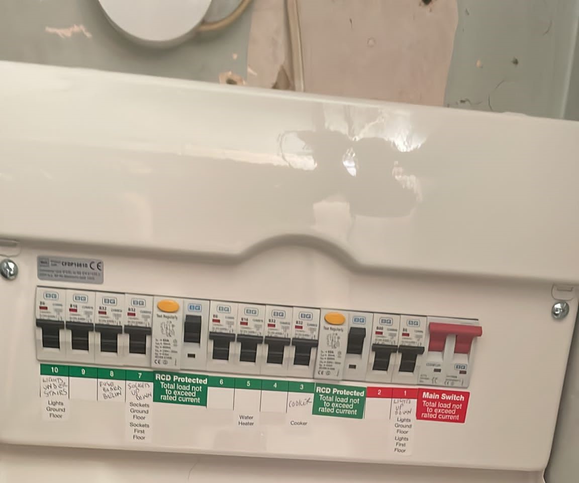

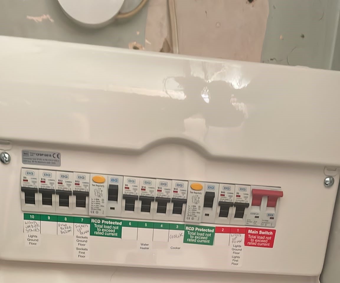

Could you post a photo of the CU ?

Domestic lighting circuits, are normally wired as what is called a radial circuit. Which means the wiring goes from the source, at your consumer unit, then works its way around all of the lights on that circuit. Unless the fault has a very low resistance, what is needed, is an insulation tester, which applies an high voltage across the wiring, to simulate the mains voltage.
Usually, the process of finding such a fault on a radial circuit, involves disconnecting the radial circuit, at certain points, followed by retesting to see whether the fault remains or not, so you can decide whether the fault is in the near section or far section, beyond where you have disconnected. The quick way, is to guess where the middle of the radial circuit is, break and test each half - Logically half'ing, then quartering, and so on, until you have got the fault cornered, to a small section of cable.
no it has not but, I wonder why the the light circuits on mcb
In view of that picture of the consumer unit, (a bit different than the description and certificate) I would hazard a guess that you might have what we call a borrowed neutral on the stair landing light circuit.
If I am correct, this will indeed require some rewiring of one of the lighting circuits.

many thanks will start with those lights and see what I can find
