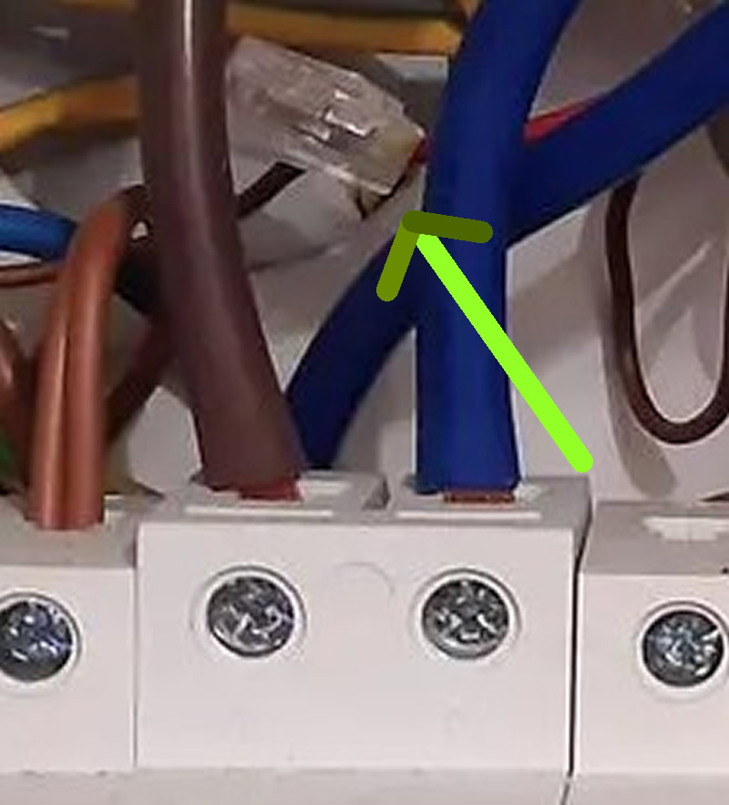

In the CU, directly above the left hand RCB, why is the CPC connected to a red wire?

RCCB or RCD.
Can we see well enough to ask things like that?
Yeah, RCD, it was a typo.

My strategy to tackle this problem was to use the knowledge I gain for the contributions that were posted here to do as much as I can and will call the professionals whenever I get stuck. Hence, I worked in the house all this weekend, I inspected all the wires of the lighting circuits of the first floor from the loft, they are in good condition nothing is chewed or damaged. Sleeved every earth wire. One junction box was a bit dogy and was sorted out. The kitchen light natural and earth was a bit loose and were sorted out alongside the outside front door light. Basically, I inspected every box and switch that has wire coming into it or out of it. Finally I connected the light circuits to the protected side by the RCD and it worked . All the circuits are RCD protected now. This was rather strange insulation; I was expecting to find all the connections in the light ross. They were all done via junction boxes in the loft and under the floor board and only 3 wires coming out of the ceiling to the light. Time to call the electrician to issue new EICR. many thanks to whoever contributed positively to this problem.
The problem is, you have not identified for certain, a fault - therefore the fault may well return in the future.
any potential problem should show up in the EICR. I believe the electrician will check every connection as I have seen him did in the past and produce the report. the comfort I take from this weekend exercise is that every circuit in the house is RCD protect which is much safer then before!.
