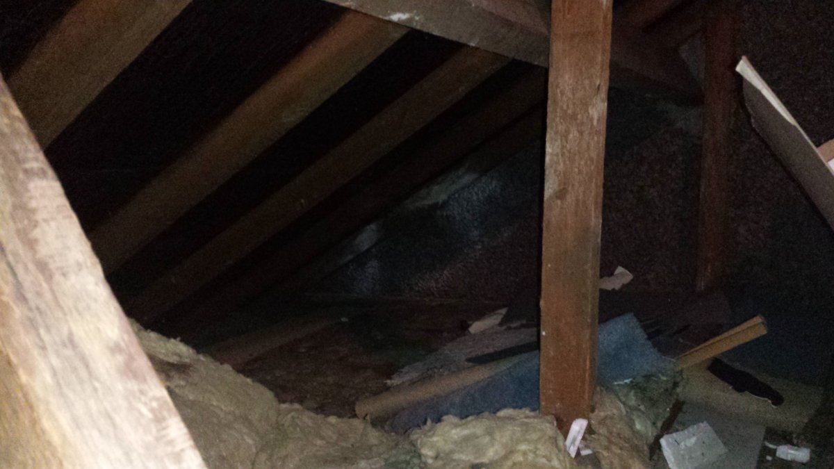

Ok, more possible bad news. I went up during the rain we've just had and couldn't find a leak but while there I turned off the light and happened to catch a little bit of daylight from a different area. We've had no leak there at all but I'll need to get the sorted too. The worse thing was I shone my torch around different areas and I think I've found what seems like it might be dry rot.

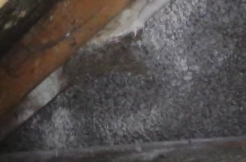

It's in a corner on the other side of the roof and in shadow, hence why I'd not seen it before. It looks like grey cobwebs on the beams. I tried the damp meter on the wood there and it didn't actually come up as particularly damp. I was just reading and this sounds like dry rot? I managed to get some of it back when I pulled my damp meter back it seemed like strands of grey cotton (not cotton wool). I'd almost say it was like a large dusty spider web. I've attached a photo as good as I can take one. I'll try to get closer next in a bit. Stupid me disturbed it though so if it is dry rot I've probably thrown it everywhere.

Ok, my builder has just been and he said that the new thing I found was a leak but he went outside and from the ground said the roof looks sound although he'll check another time. He thinks it is an old leak. I tried to do a screwdriver test on the wood (from a screwdriver on the end of a long pole) and I couldn't get it to dig in at all. Obviously it would be better to be there doing it directly by hand but I couldn't get over there. I did manage to get a ball of the grey stuff back and it is very dry with stuff like paper in it (my wife thought it was like grey dusty leaves), plus some strands that are like cobwebs. I've attached a picture. It looks like the remains of insect nest to me, but I don't know what of. We did have a bees nest that exited through the eves near that area this summer but it doesn't look like a bees nest to me. I've got a couple of videos of me rolling it in my hand.
Anyway, I showed the builder the felt slip and he said he'll sort that. He again said the flashing looks like it needs doing and could cause the issue. He said the pointing seems fine and that when he did some previous work on the chimney it seemed good. The flaunching could need doing but he said it would be more likely to cause issues on the chimney breast itself or further down, but that doesn't rule it out. He also said it could just be condensation and said our house did feel like it could be that. He said that if it were moisture in the roof it should move around but if the condensation is in the top around the ridge then that can be a problem.
