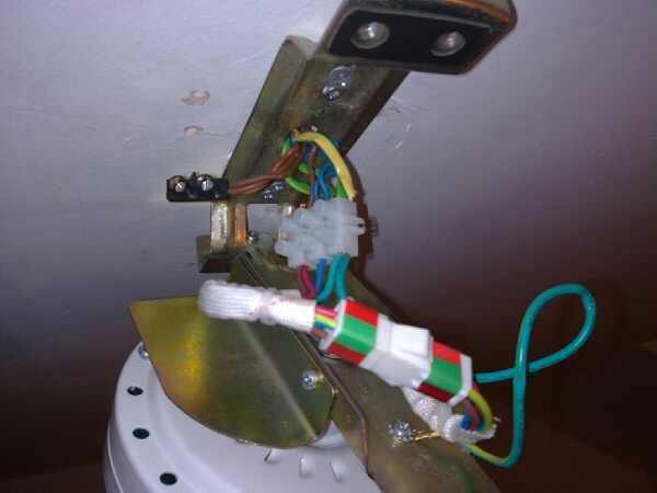

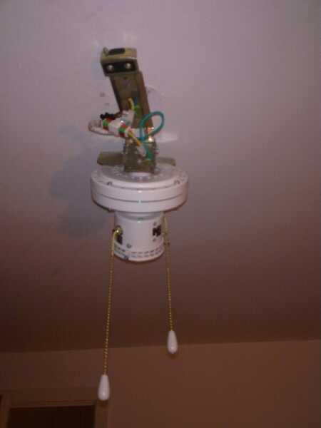

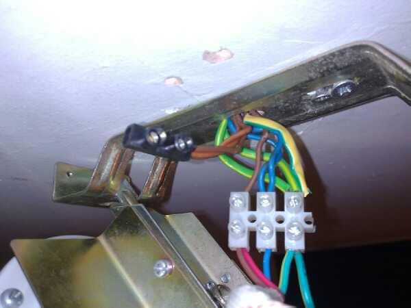

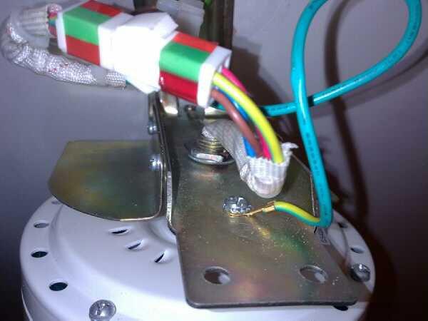

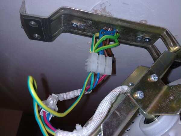

this is what completley baffles me, it was tripping the circuit then i took of the casing took a look at the wires everything looked fine so i turned it on again and the fan worked, so i put the casing back on and ever since then when i switch on the switch it not tripping the circuit but the fan will not turn on. i will upload some pictures
For a start those wires pass through that metal mounting bracket.
There is no grommet fitted so those wires will chafe on the sharp edges of that hole.
Look closely and you may see damage on the insulation which is causing a short.
ok il inspect this closely tomorrow. so does a short not always trip the fuse?
I think I can already see a nick in the live wire in the second photo. I think you really need to take more time with your cable preparation. Bend the individual cores into shape such that they will sit nicely inside the enclosure, rather than just stuffing the lid back on as tight as possible and hoping for the best.
sorted it, i removed a few cable clips in the loft so i could feed more of the wire through, put some more protection around the wire coming throught the mounting plate and cut off the wire that was causing the short. thanks for all your help
