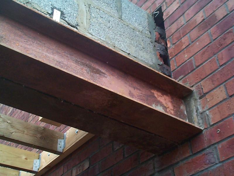

I have a whole floor held up with these self tapping bolts.
In the case of a floor there is no force attempting to pull the bolts "out" of their hole, you'd need to shear them.
A balcony on the other hand will pull the bolts out the same way they went in as it can rotate, since it's only supported at one end. Your floor would have to be a mesanine supported on one side only to be comparable.
