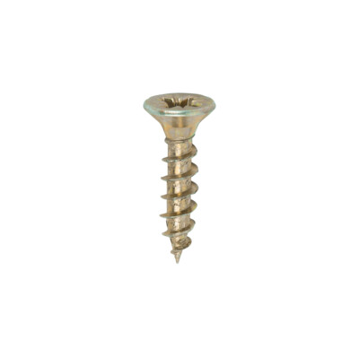

Just a quick update it seems every couple of months the two 4.5mm screws come out ever so slightly from the two dowels that i glued in, i suspect that's due to constantly opening and closing the cabinet door. I was just wondering if there is an alternative type of screw that i can use for chipboard that has a thread on it that doesn't come out easily once it's screwed in please?
How long were your screws? And did you drill a small pilot hole before driving the screws in?

yes i did drill a pilot hole before driving the screws in. These are the exact screws i brought below:
Most likely dowel wood too soft and widening the threads. Drill dowel and insert wall plug.

Thanks am going to drill out the dowels tommorrow and insert two wall plugs hopefully that holds it better.

I can't see that you did anything wrong.
Is the door subject to a lot of use?
I would not recommend using nylon wall plugs.
I would recommend inserting some matchsticks in the screw holes (using superglue to lock them in), and this time only use a a 1.5mm pilot to help guide the screw.

What is the reason you don't recommend using wall plugs?
What is the reason you won't use the repair plates?
I suppose I could but would using a repair plate stop the screws from becoming loose over time? I don't trying bigger screws and wall plugs, i just measured the thickness of the cabinet and it's measuring at 18.13mm if there are any bigger screws and plugs i can try?
Repair plate gives more fixings spreading the load, you could have grown a tree by now and use the wood to make a new door!

Am gonna give that ago, seems like the easiest option and as you say if it spreads the loads it should hold up better.
