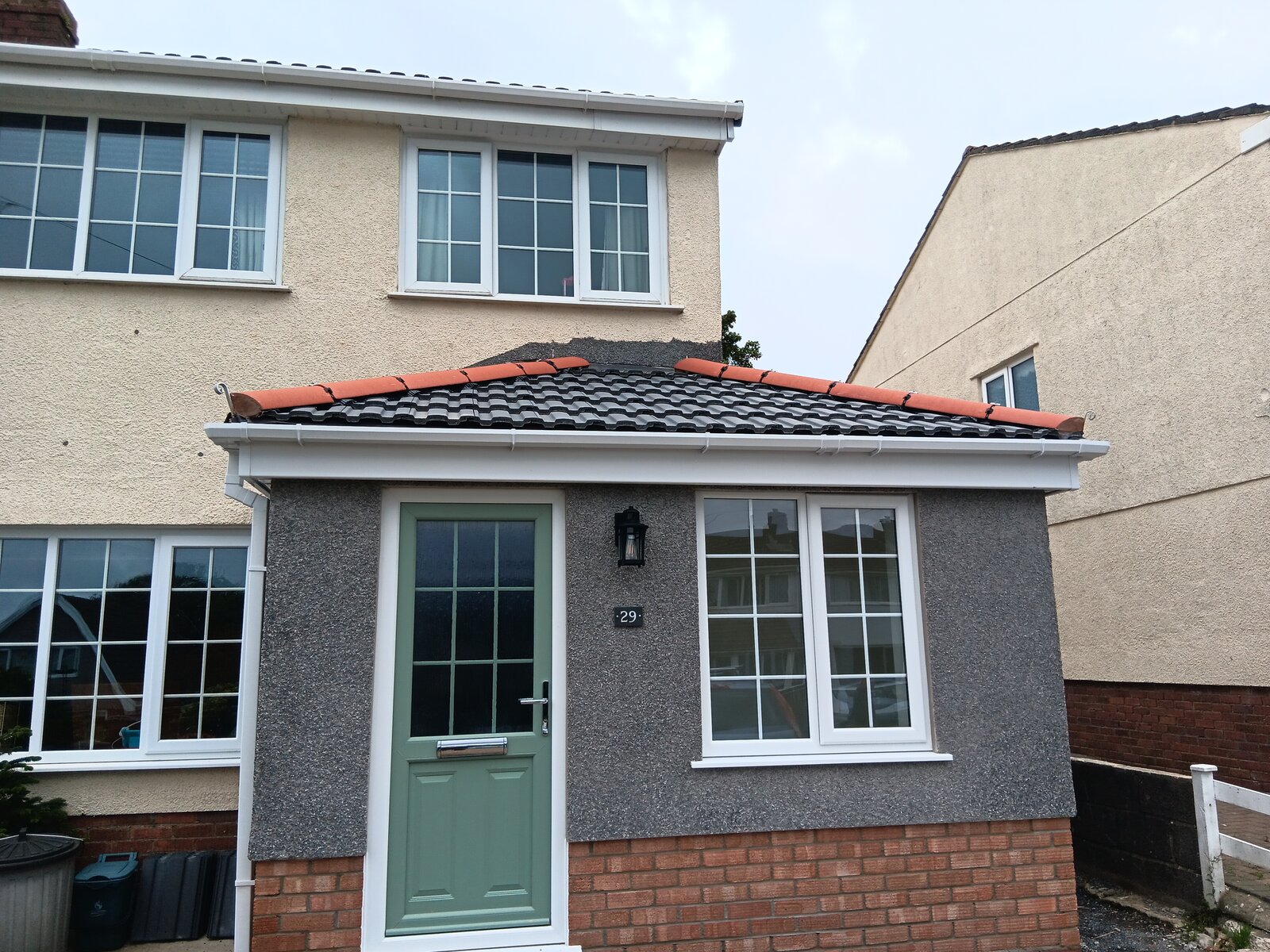

How to fix this flashing.
Thanks for the responses. These are redland renoun smooth. Looks like cavity trays have gone in too low on the front porch extension also, messing up pitch of top tiles.
Given the width of the flashing around velux, is the up kick a problem?
So just a copy of Marley Ludlow majors then with a 5 degree better pitch rating.
I have never heard of them, but I am a little suspicious as to why Marley only rate them at 22.5 degrees.
I think perhaps the marley tile do now go to 17.5 too. Not sure though.

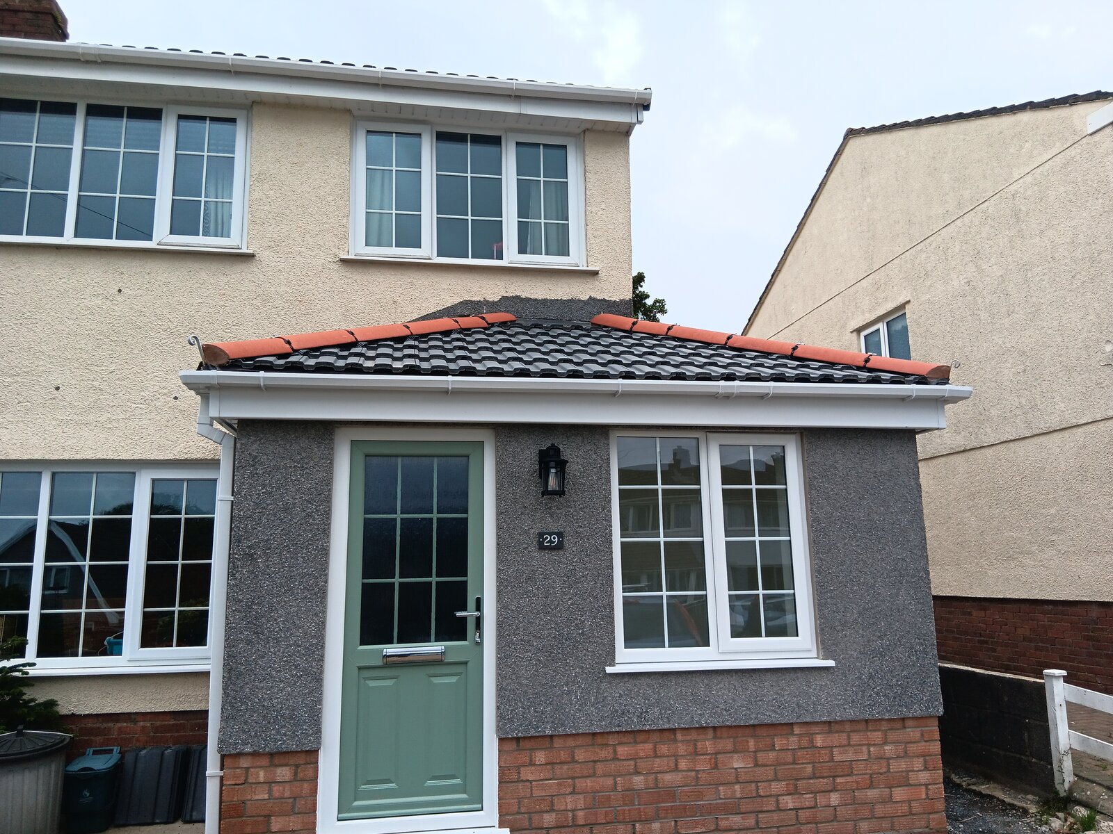

Is anyone able to explain the wonk on these ridges too and the raised top line of tiles. Have they also put cavity trays in one brick too low?
