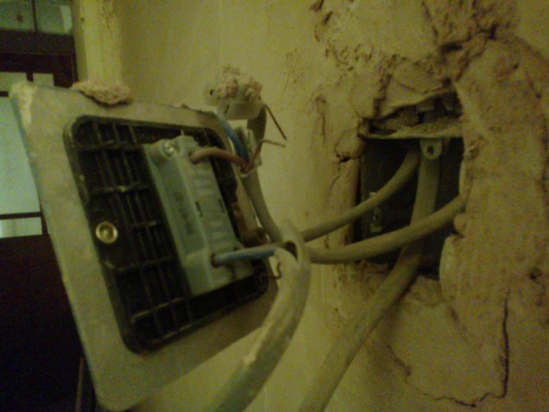

This is the inside of the socket and yes if i put a bulb it will work
If this was done by a competent qualified electrician taking reasonable care I'll eat my hat!
It bears the big question of what the other electrical installation work is like, do you have any electrical certificates?
The law in England and Wales requires all electrical work (in domestic dwellings): "P1 Reasonable provision shall be made in the design and installation of electrical installations in order to protect persons operating, maintaining or altering the installations from fire or injury."
One method of compliance with this is to ensure the installtion complies with BS7671:2008 (AKA IET wiring regulations). They can choose to not comply with this but then it is up to them to show how they comply with P1.
The law also requires electrical works to be notified to building control (unless on the list of non-notifiable items), a hallway light is likely non-notifiable however it still must comply with P1.
Leaving switches hanging off walls with accessible live parts and disconnected protective conductors doesn't, to any stretch of the imagination, comply with the P1. The cable is also looking a bit big to me (not that this is a major issue, just an observation)

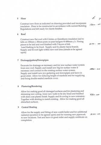

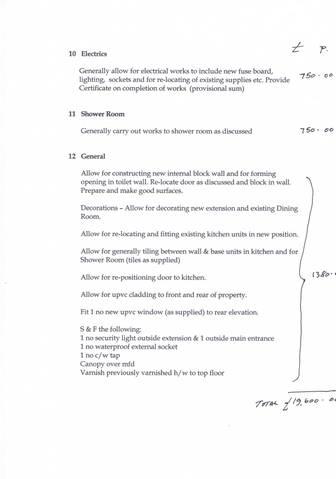

I am uploading part of the estimate, the rest will follow.

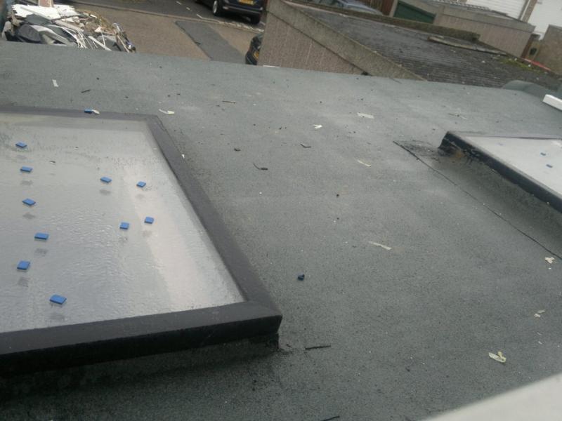

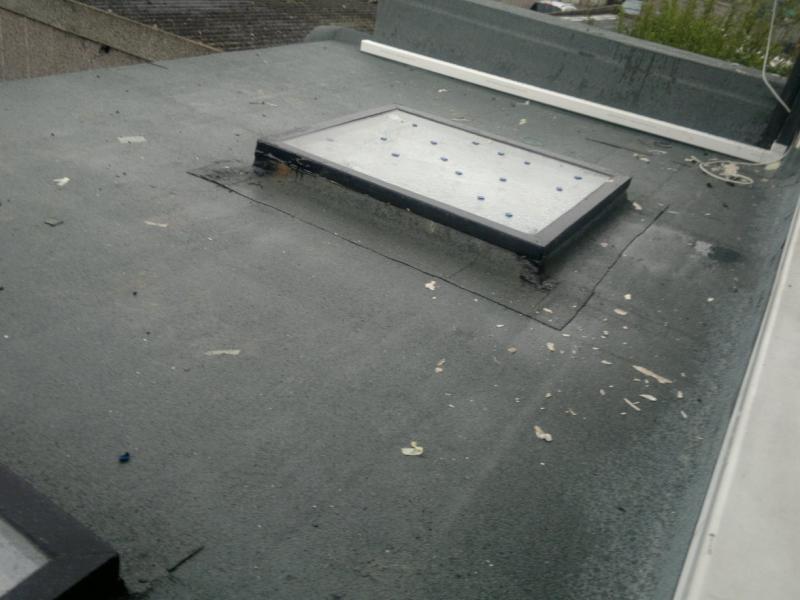

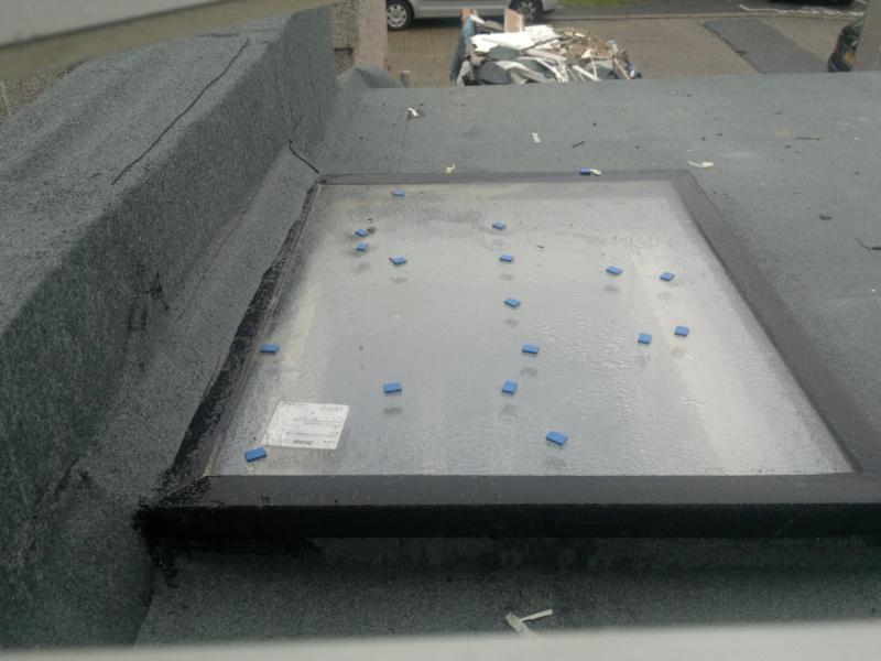

Could anyone tell me what they think of the roof?
If you want an opinion from someone who does roofing it may be better to ask in the roofing forum, I can say it doesn't look that nice but I don't really know my knee from my elbow with roofing!

The terms look pretty specific from the attached document in what the builder was intending to do for the price woody. If the estimate continues like this then the builder may well be right to be asking for the extra works to be paid for. Note : I'm not commenting on the rightness or wrongness of this, nor his pricing nor his quality of work.

Can you post a copy of the drawings too as they form part of the quote, for example if the drawing shows the ventilation in the shower room, they can't really expect to charge extra for it.
It's difficult to pick things out and I'm sure someone more knowledgeable will be along to comment but they seem to be expecting to charge extra for things that they quoted for even though they could have quoted correctly in the first place. For example, they quoted 2100 for fitting the new boiler, but then seem to say that the boiler cost them 420 more than expected, they could have verified the cost of the combi at the time of the quote so in my view can't expect you to pay more.
The 17 point list, what is the title of it, how was it described in the email or whatever it arrived in? It would be helpful if you could point out the number which you know yourself are extras so they can be eliminated, for example 16 is about extra insulation requested by yourself, presumably over and above building regs and in addition to the original quote?
