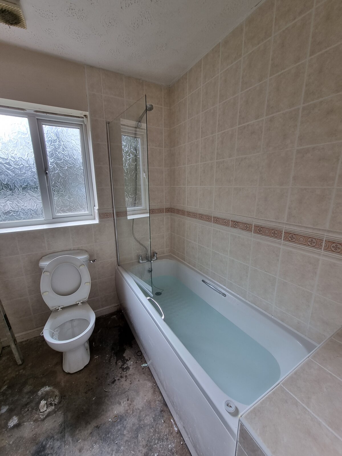

How to install a shower screen with a notched tile?

I had some recent experience with digging out grout. Dremel grout bit works. Similar bits of different sizes are available from china.
If you don’t have tools you can stitch drill (4-5mm masonry bit)down either side and break out the raised area .
Thanks for all the suggestions :) Result attached
