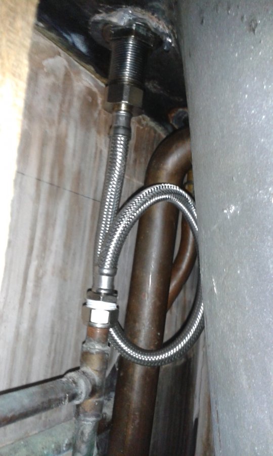

You may need a tap extender as the new tap's tail is shorter than old cross head taps.
The left tap look like 15mm copper pipe and 22mm or 3/4inch imp copper pipe on right.
Left tap look easy but right tap a pain to get due to copper overflow.

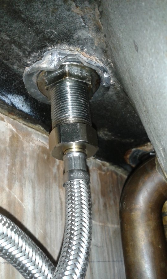

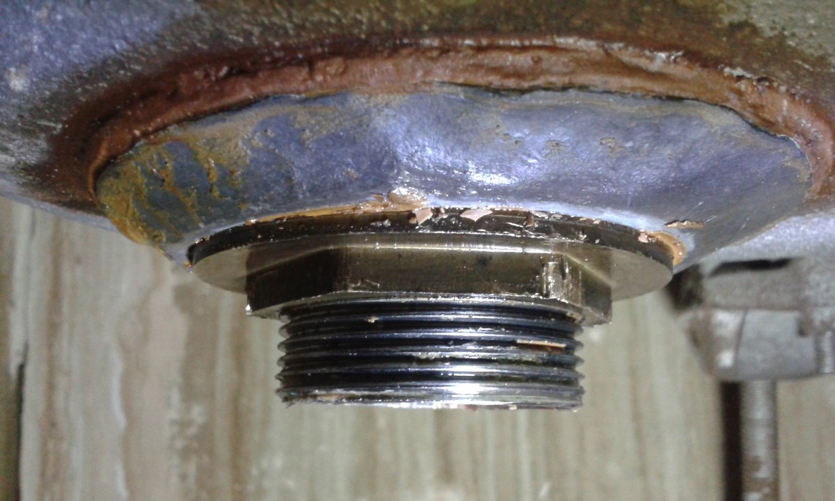

Managed to cut the pipe, but can't get that backnut off.. super glued!!. Will get the box spanner tomorrow and wrestle again.

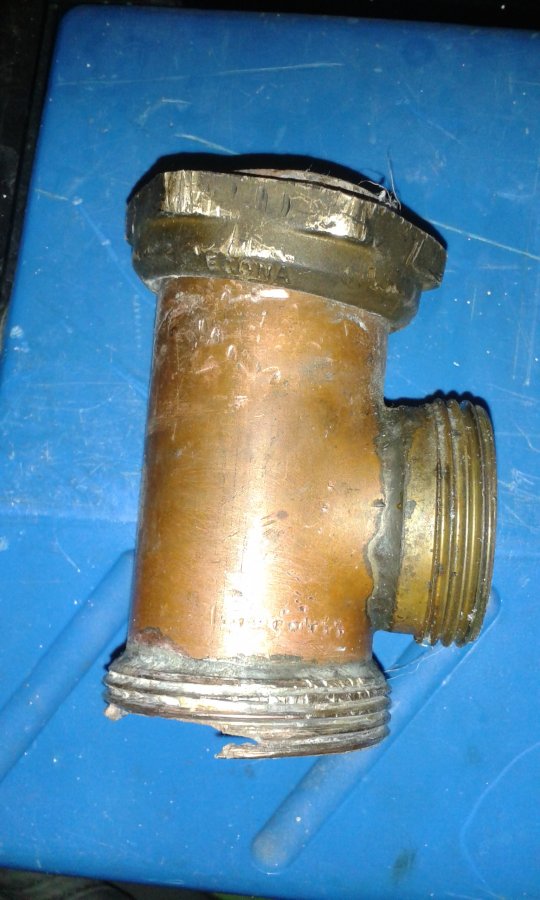

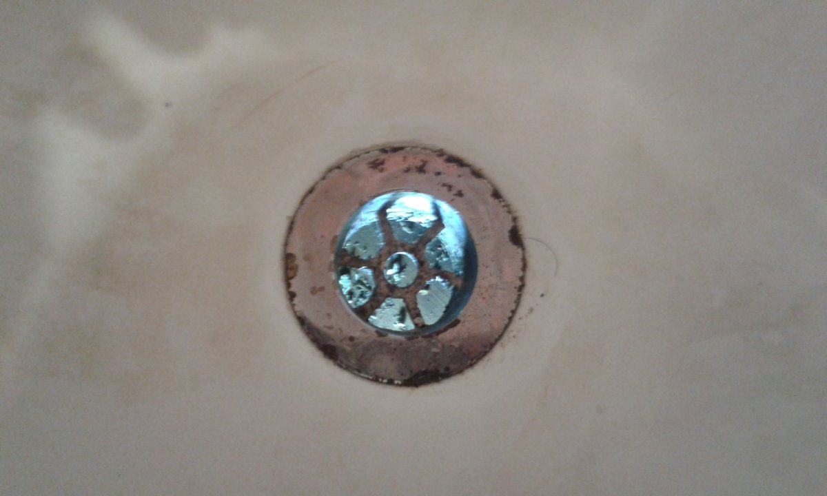

Now a problem with the drain pipe, some part of the teeth is broken, now got to get the drain pipe as well and can't use the bathtub. :(

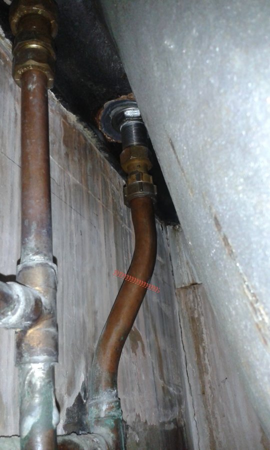

Is it OK to cut where the red doted lines is for the flexible connector?
.... when i removed the overflow pipe and the drain, the thread of the tees broke... and can't release the drain which attached to the tub (as shown pictures) Where can i get that copper tees tried the PVC but it get too low to the floor. What best way to release this glued drain so i could replace with new drain waste.

If that bath waste backnut won't budge, I'd cut it through with an angle grinder or even a hacksaw if you can get in.
