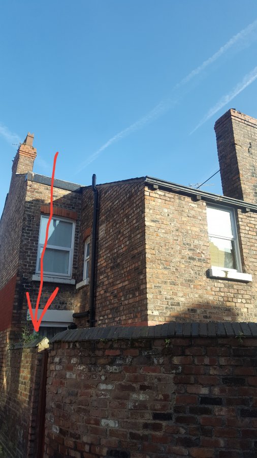

How to remove concrete lump from yard floor?

The size of the concrete "Bung" and the black on the wall suggests to me that there was originally a waste soil pipe for a bathroom, or downstairs outhouse Scullery /toilet
is it possible the bathroom was moved to the extension. What is the present soil pipe made off, is it PVC , Cast Iron, Asbestolux.
The Concrete "Bung" could be blocking the bend of the underground soil pipe.

Originally there would have been no bathroom; what is now the bathroom would have been a bedroom.
There would have been an outside loo off the picture to the right. It may have been an earth closet, depending on age.
Its a bung to block the original sewer pipe then, Cheaper and easier to install than a manhole and cover

Most detail appears to point to an all original build - main house & outrigger.
The lower ceilings in the outrigger presumably conform to the outrigger eaves/plane of the main roof.
Although, the position of the soil branch bend pipe seems odd for an original WC position?
There is a gutter behind that short "fascia" board - its a lead box gutter discharging on to the outrigger roof.
The damp in the room below could be from a blockage or a crack in the lead.
Originally, was there a down pipe in that corner position, dropping maybe into a gulley? But there's no evidence of a pipe higher up the wall?

I have spoke to a neighbour who knew about the concrete cap. As suspected, it was some sort of sewage pipe; a big one apparently, 8 inches in diameter. The other houses on the row didn't have one, however. Not sure why that is. Apparently, the previous owner had it investigated (internal camera) and they were satisfied it was not in use so it was removed and capped off with the offending concrete plug. Mystery solved. I think I'll leave it where it is, though. Already got a list of jobs as long as my arm.
To answer your other questions, there is no gully in the yard, but there is a drain at the bottom, and yard slopes down to it. I think you are right in stating that the WC position is not original; I believe the previous owner altered the size and layout of the bathroom, so the position of the soil pipe was moved. The soil pipe is plastic and relatively new, supporting that. Also, we were made aware of the leaning chimneys when we had the survey, and it's on the to-do list.
