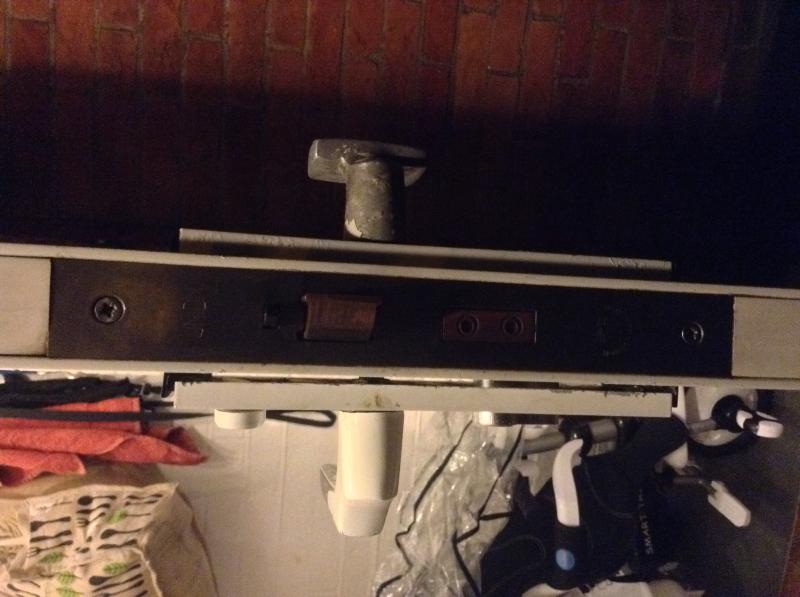

Difficult to see in pic but wanted to demonstrate the PZ on each side were the same. It is due to the internal mechanism of the door that lends itself to needing the two shorter spindles.

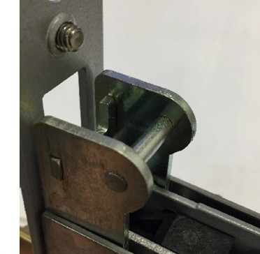

  2. Access the Rods: Once the handles are removed, look through the slots at the top and bottom. You will see the rods attached to a bracket by plastic sliders clipped over their ends.
  3. Unscrew Gearboxes: Unscrew all the gearboxes to allow some movement. Pulling out the case will reveal the plastic sliders.

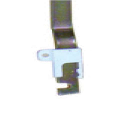

  4. Unclip the Rods: Carefully slide the clips away just enough to unclip the rods. Note that some models may have a bolt securing the clip, which must be removed first. Avoid dropping the plastic clips into the door cavity, as retrieving them would require door removal.
  5. Replace Gearbox: After changing the gearbox, push the rods back onto the gearbox and slide the clips back down to reattach the rods. Again, handle the plastic clips with care to avoid breaking or dropping them.

The first picture shows the rod from the side along with the white plastic clip. The rod has a space or hook that connects to the bar in the lock (as shown in the second picture). The white plastic clip slides down over this connection to secure the rod in place.
