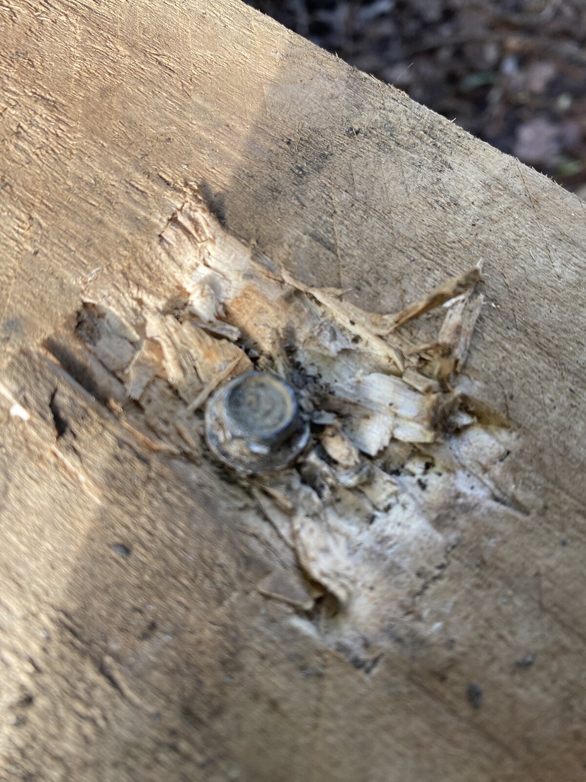

I have all these huge hex screws in my sleepers in the garden that I need to remove but they are all rounded or rusted and a drill can not get them out. Any advice on how to remove them please! Thank you.

Show us a pic of the socket you're using on them (show the hole the bolt goes into) and tell us what size it is- looks like an 8mm bolt to me
The bolt pictured looks like it still has enough left to grip so long as the socket isn't ruined or a 12 point star
If you've reached a point where it's rounded too much you may need to consider using an angle grinder with a thin blade to cut part of the head off to leave you with two decent sized flat spots either side and clamp some mole grips on. If really ruined you may need to grid the head off then see if you can separate the sides with a heavy hammer. Those bolts are usually only partially threaded so the wood under the head won't have as many threads gripping it to the other side
