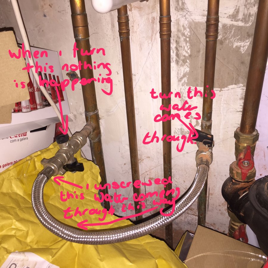

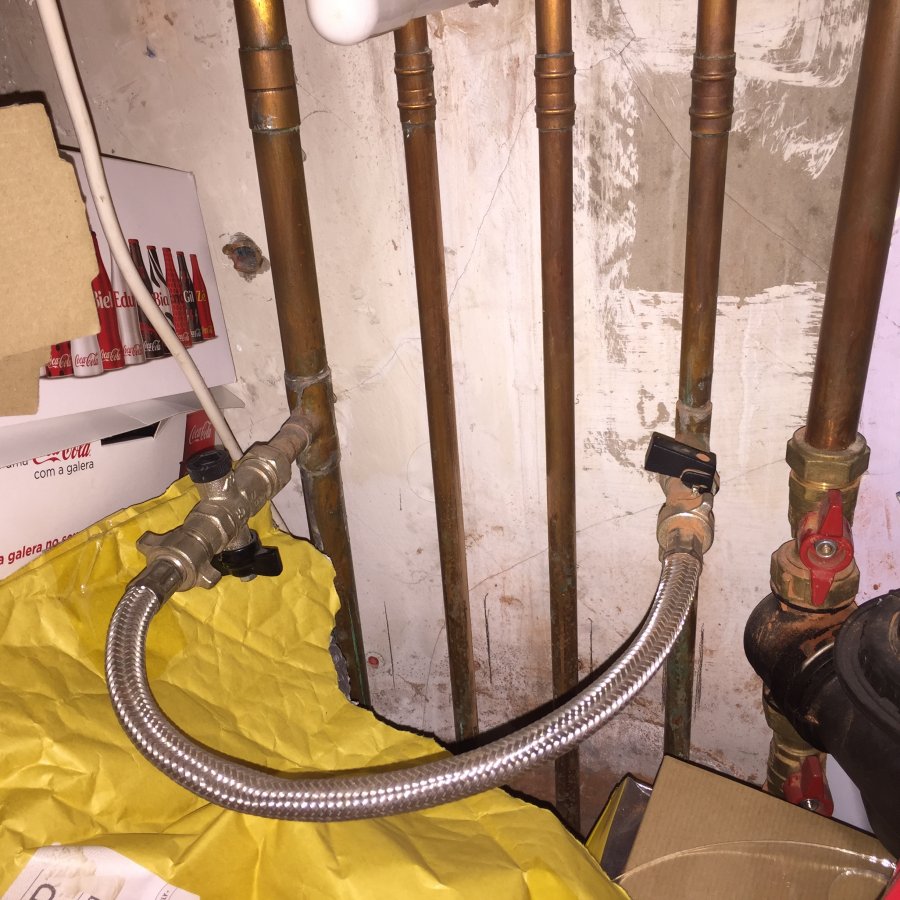

Hi
i am having some issues remembering how to repressurise the boiler i thought i lowered the blue switch, then onto the circle silver things then open the black switch. But nothing is happening. i have provided some pic if anyone can help got a baby due i next couple of weeks and i want to make sure everything working the way it should to ensure it doesnt stop when mum and baby are at home alone.

The braided pipe(silver ring) in the second picture is the filling loop. To let water in to the central heating circuit, you open both the black handled valves, on either side of the braided pipe. Then when you reach the required pressure close both valves. Then vent the radiators, put more water in if required.
Ideally when you have added or before you add water to the central heating you should also introduce some more inhibitor and when the filling loop is closed, it should be removed (but happens rarely!)

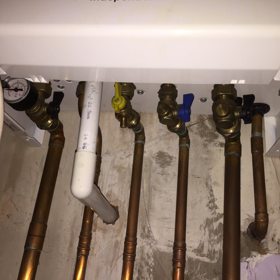

The blue valve if closed, will stop the cold water being supplied to your boiler for the domestic hot water to be heated.
I turned the blue valve and the open both black valves in filling loop and nothing and when i open the black valve next to the water pressure psi thing its not filling up
You do not touch the black valve at the pressure gauge, that will close that leg of the central heating circuit.
And you do not touch the blue valve either.
The braided pipe and the valves connected to them is the filling loop. No other valves to fill the central heating system should be touched.
so you tell me i just need to open the two black valves on filling loop???

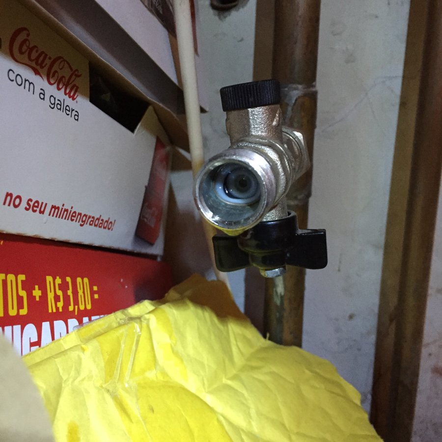

so ive just been up and checked the filling loop i unscewed it on the left hand side and water came up when i open the valve on the right. but when i reconnect it and then open the left valve nothing is happening the water isnt going through by the looks of it.
this seem the be the one causing me the issue

That is a check valve and is operating correctly. It should not let water out of the central heating system pipework into the cold water supply.

I am not sure why the OP is unscrewing the filling loop - it looks securely attached, just leave it that way and operate the two attached valves until the pressure is about 1.5 bar.
Then close both valves.

OP: the only 'handles' you need to rotate are those that are at each end of the flexible silver hose... nothing else!
i did notice that the left hand valve it feels a little lose and saw a little bit of water just the odd drop
