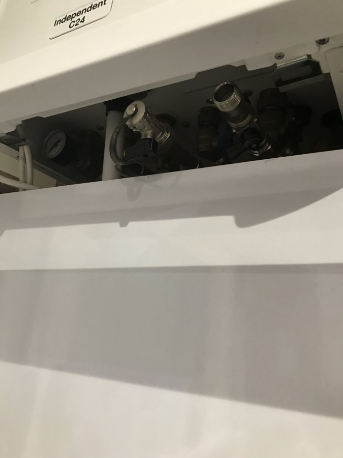

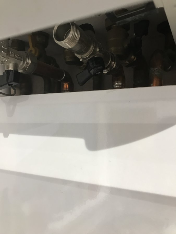

Hi there, have a similar issue after bleeding radiators last night I have found this morning my pressure gauge has hit 0. My issue is I cannot get to behind a white wooden panel below the boiler which I belive will house the loop which you have discussed.
Will this panel need to be removed or can I fix using the knobs I have in pictures?
Thanks in advance.
