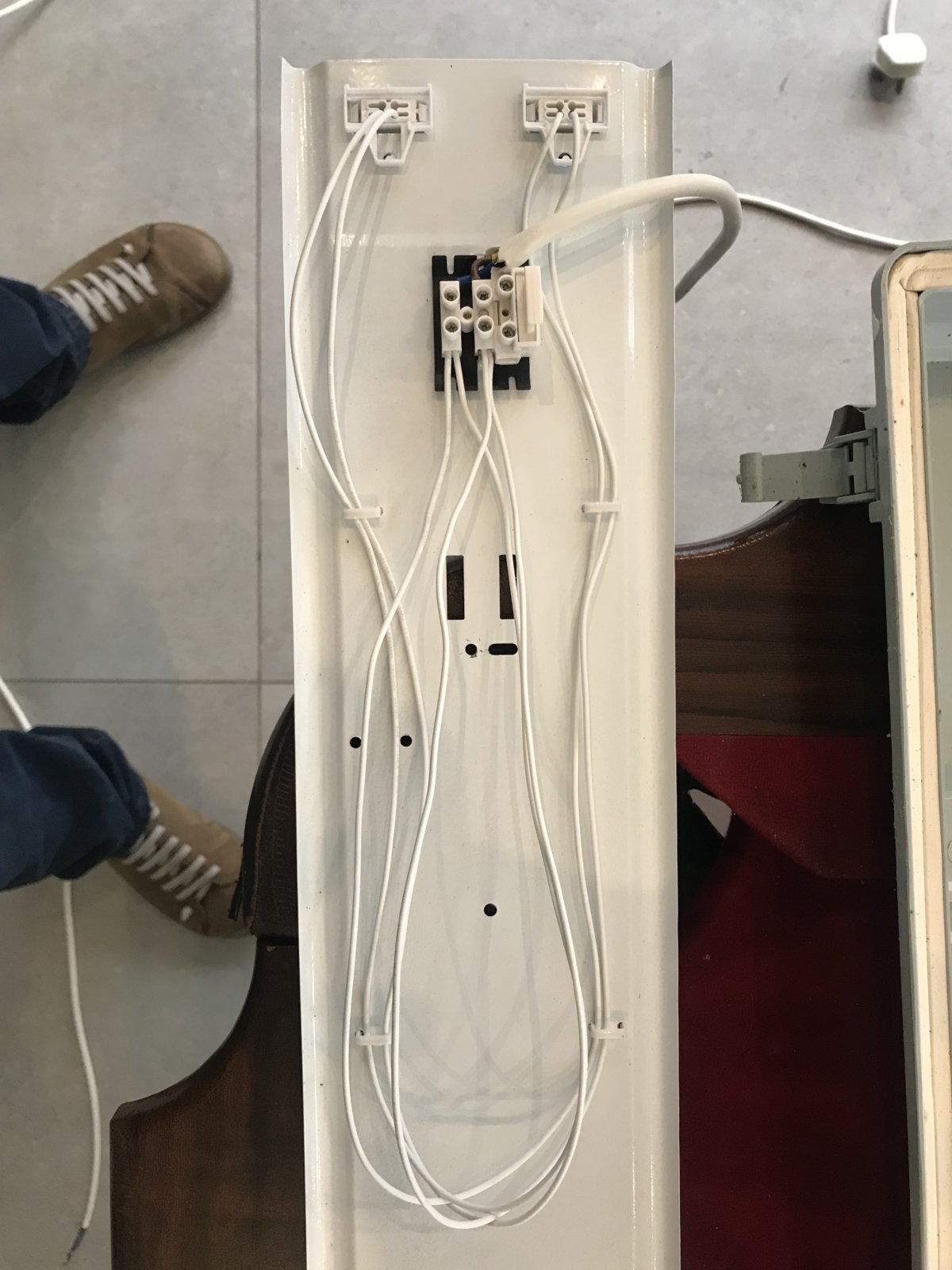

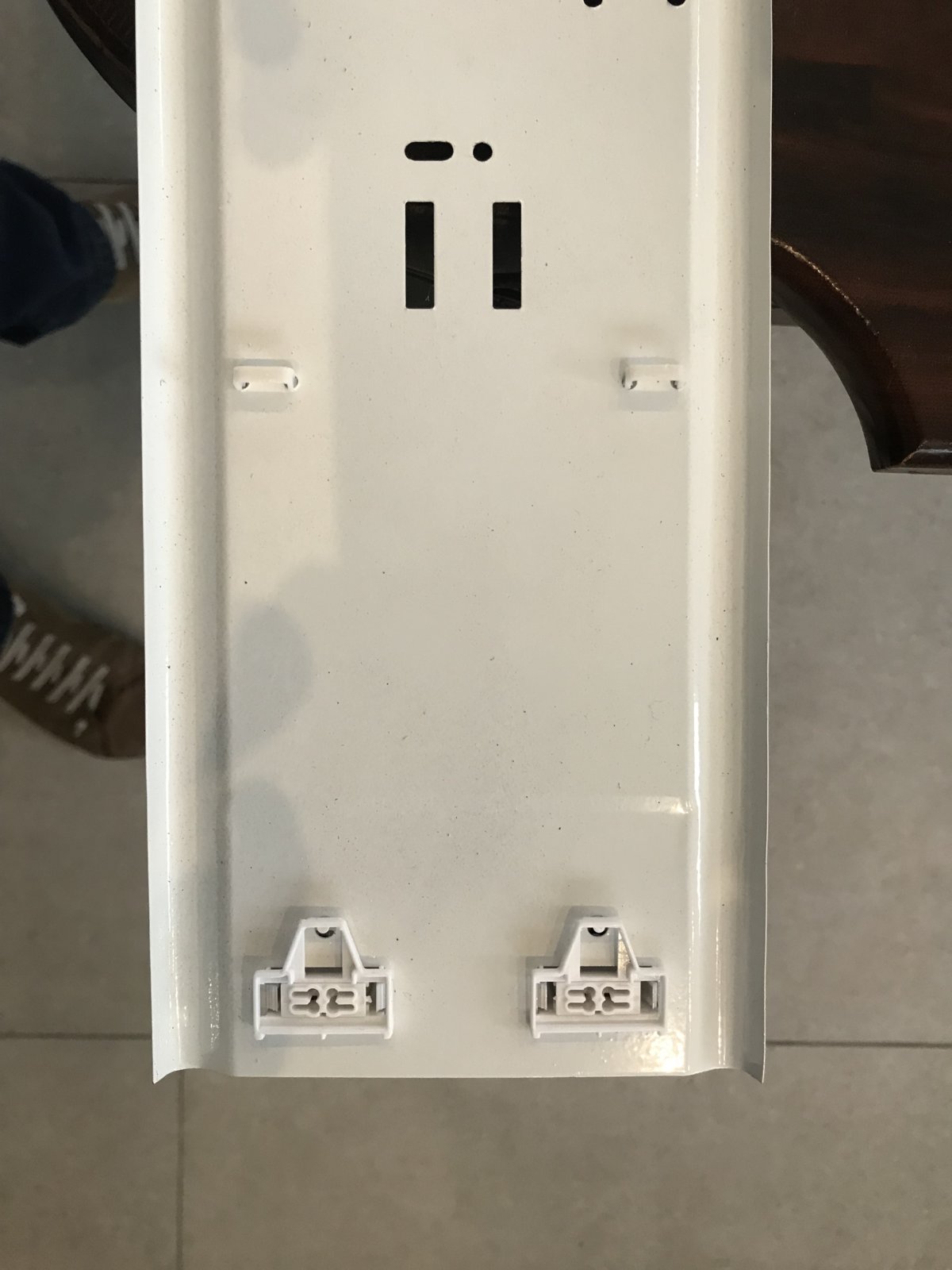

Your wiring is wrong and dangerous.Attached are photos of my wiring
