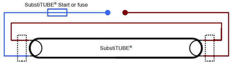

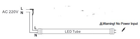

You currently have this wiring layout as per TLC LED tubes:

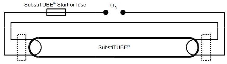

I also downloaded these instructions that suggest that Osram tubes have a slightly different setup than those from TLC.
http://led.omega-light.com/Lum/lum_files/osram/substitube-installation-instructions.pdf
One end of the tube has the driver, the other end (I presume) has a loop.
I am now making presumptions, but I presume that they have done it this way so both ends of the baton have a live and Nutral so you can put the tube in either way around. (You do not need the SubstiTUBE Starter as you already have an inline Fuse).
With your current TLC wiring if you put an Osram tube in the wrong way round, because it appears to have joined pins at one end, it will short circuit the wiring and a fuse will blow.
So (after you have checked the fuses) can you determine the 'driver' end of the the tube and can you put this end of the tube at the end of the baton that has the power.

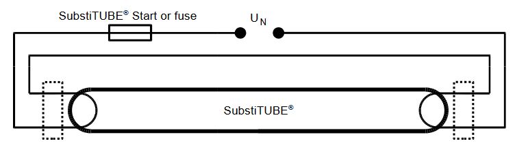

Where does it say put L and N on one end, it looks to me like a retrofit for a switched start unit therefore i would have thought L and N would be at opposite ends and the other pins linked by the dummy starter
Rocky
The Osram bulb shows a diffrent wring for the TLC.
But I read it as showing the same wiring layout.

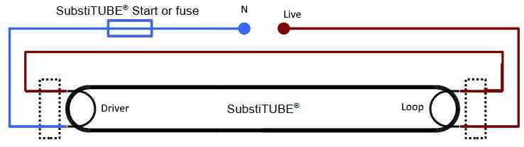

The Osram Bulb is shown as follows:

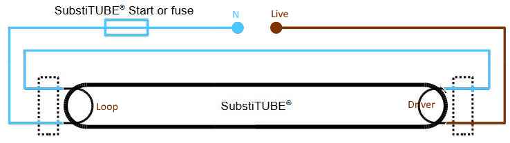

Which also shows L and N to each of the pins on one end of tube so it works as follows:
And the benefit is that it also works if driver is at other end of the tube.
So I think Devs wiring should work perfectly as long as he puts the Driver end of the LED tube at the end of the Baton with the wires.
