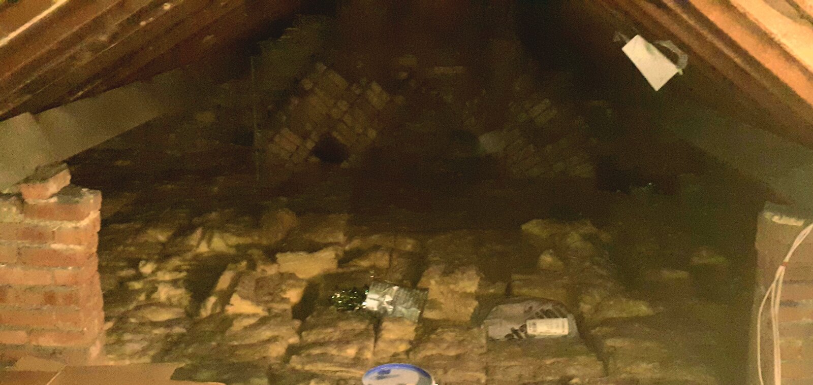

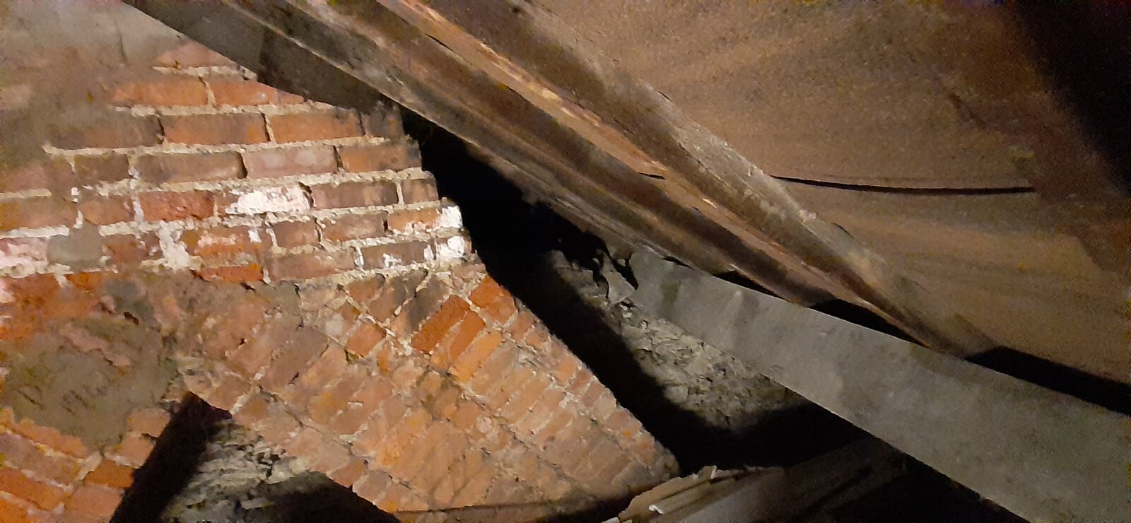

Most of the Victorian terraces around me still have open lofts. The pics show my neighbours loft and the large gaps through to the rest of the terrace:

If you have smoke/ odour coming through, then the compartmentation is defective and so the fire compartmentation - which should be the concerning thing.
The cause is gaps, plain and simple. In the floor voids, wall edges, loft. Difficult to remedy, and requires lots of intrusive work.
However, use of a positive pressure fan may help. Alternatively, you could use environmental law to get the neighbour to sort out the problem one way or another. The local council could enforce this.
