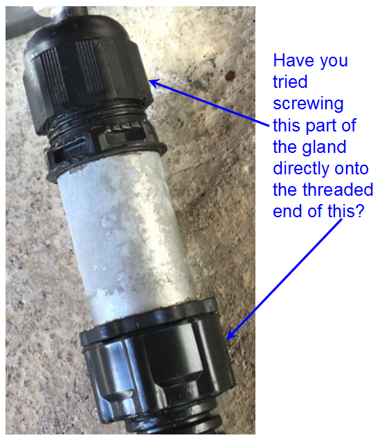

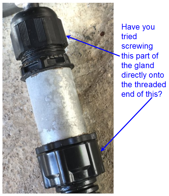

How to terminate a cable out of flexible conduit
I have had a look inside the light to see if the hole can be enlarged, but there is lots of metal moulding on the inside, and the gu10 lampholder is in the way of making a bigger hole, or even a new hole.
Also unfortunately the glands can’t be screwed together directly.
Different glands have different designs.
Some are M20 both sides.
Some have compression inserts which can be transferred/adapted.
What size is the existing hole?
If it cant be enlarged, purchase reducing adapter from 20mm to fit.
May have to look at PG sizes
