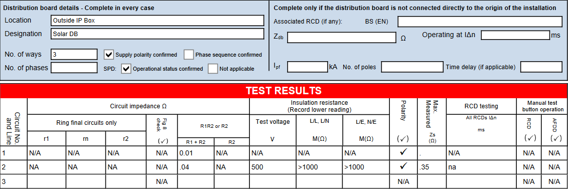

Yes for all the good it is, no RCD trip times, no resistance entered for the earth rod, this
Is all it says, two RCD sockets fitted in a kitchen so notifiable, and no test results for them. I saw them measure the earth rod resistance, but no figures entered. And I would have thought serial number of the tester should be entered not just make and type?

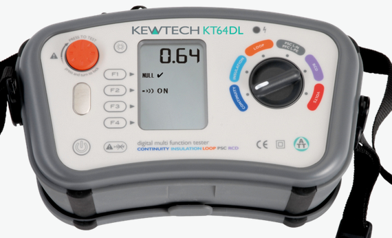

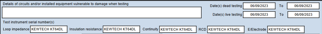

I don't think "KEWTECH KT64DL" is a serial number? They all seem to have the same serial number 1698622090795.pngwhich seems odd.

You are correct about the missing serial number for the tester.
What is circuit 1?
