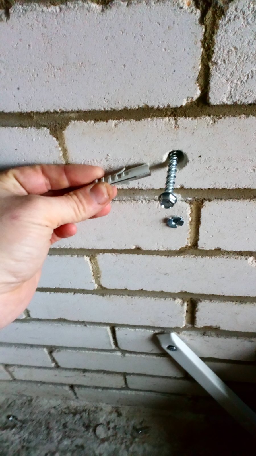

Tried these as well. Hardcore screw.
Anyone know material am drilling into? View attachment 133688
This bolt/screw thing is really strong. Just put it in.
The other two were pulling out of hole or turning when I tried to do screw up. The plug is 10mm so hardcore
That's a 6mm thunderbolt. You don't use them with plugs.
Just drill a 6mm hole.
And are the best form of fixing into masonry.
Yeah, it's one of the longer ones. Is it supposed to go behind the back (2nd) plasterboard and expand behind it? I am using it in these brick sized white soft things which are more crumbly and normal red bricks and brown plugs don't get a great fixing - will send photo. They arent as hard as orange bricks. I used a shorter expanding fixing before in crumbly old plaster (in an old house) where the hole was big and it worked well,
Can you get thunderbolts out relatively easily when you want to take them out? Best to put them in and out with a rachet?
