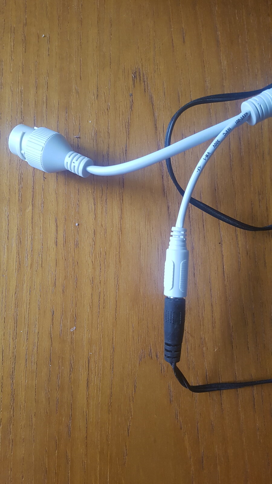

Have got some 2mp hikvision cctv cameras to supplement some areas at the back of the house. It was a bargain (3 of them for £30), so I was OK with them not being POE / needing an additional 12v feed.
To the point.
The cameras have a waterproof ethernet connector jig, however, the 12v doesnt look like it would survive long unprotected.
Its the one plugged into the black cable.
How would you go about waterproofing this? Ideally, I'd like to put both connectors in a weather proof junction box and use grommets round the cables to make the box water tight.
However that would mean cutting these cables, which I'd prefer not to do.
I looked at the compression glands, however, to fit the plug through it would need a usable cable diamater of 3mm to 12mm (most support 6mm to 12mm). I guess I could use a larger one and bung the space with silicone but that feels wrong.
Anyone have any brilliant ideas?
There is a watertight, stretch, rubberised tape (name?), which you can use for that.
[EDIT] that's it self amalgamating tape. You pull it hard to stretch it, which causes it to become very sticky. Wound tight enough, it becomes a solid rubber lump, which can only be cut off with a knife.
I've purchased some amalgamating tape (was £4).

Thank you, as, this is the proper solution.
However, as I've managed to womble and cobble together a 6 cam night vision system, poe switch and nvr out of parts I owned, or was able to get for free, £30 on 3x hiks was my biggest spend.
The miser in me doesnt want to spend more on water proofing when £4 will do it.

Use a wiska / geweiss box and nick out a little bit of the bottom of the box where the lid meets the box to allow the cable to exit whilst still retaining a nice snug fit on the cable.

As RF says. Or get the mounting back box to suit the camera.
