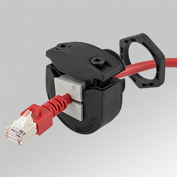

How to weatherproof a pre-terminated RJ45 cable? Cable gland that's large enough for plug leaves too much space around cable

If you drill the hole in the base of the charger housing rather than the side you can gland it with a lump of silicone to stop the spiders.. Water doesn't flow upwards so you're sorted in that regard.

icotek.com/en-gb/cable-transit
