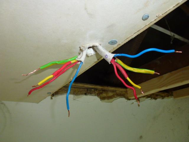

Thank you all for the quick response. Apologies for the previous lack of pictures. I hadn't realised I could upload them
The problem is entirely my fault. I disconnected the rose without properly noting where the wires went but it does mean I know everything was working previously.
Starting at the switch end, I have one two gang switch.
The cable from that is the left hand one of the two shown and has red, blue, yellow + red tag and earth wires.
These feed a porch light.
The right hand cable is also red, blue, yellow + red tag and earth and goes on to feed the outside light. The red wire is capped off at the light so doesn't do anything but was previously wired in at the ceiling rose end, presumably for safety reasons.
The ceiling rose has three sets of connectors and separate earth
So the question is how do I wire this so that one switch operates the porch light and the other the outside light.
Tom

And the photograph of inside of the switch?
Is there terminal strip inside the switch holding the neutrals?
Do you have a multi-meter?
Power off.
Firstly, at the switch, confirm that the blue wire is connected to other blue or black wires and that the brown or red from this other cable is connected to the Com (with Com, L1, L2 terminals), (It may be L, L1, L2 or L1, L2, L3 - if so then transpose).
Only if it is as above - connect the red wire to L1 of one switch and yellow to L1 of the other swich and fit a link wire between the two Coms.
Connect all cpcs (earths) to earth.
At the first light, connect both reds to 'Live', both blues to 'N', both yellows to 'Loop' and cpcs to earth.
At the second light, connect yellow to 'Live', blue to 'N', red to 'Loop' (if using another rose or, if not, in a separate connector to terminate safely) and cpc to earth.
Then draw a diagram of what you have done so that you may understand what you have done for next time.
If you don't have at least a multimeter then you must get one before doing any other electrical work.

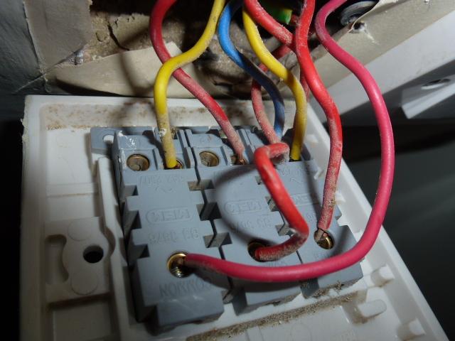

Picture of the switch attached.
Turns out the switch is a three gang rather than a two gang.
As far as I can recall,
- the switch on the left as you look at the picture is for the outside light
- the switch in the centre is for the porch light (although the cable for the porch light only actually runs from the ceiling rose to the porch light and not to the switch)
- the right hand switch is for the inside light
The only blue wire in the switch goes to the connection at the top right as you look at the photo. There is a cross over connection from here to the bottom side of the centre switch as you look at it

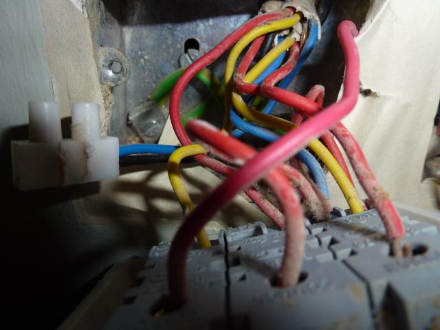

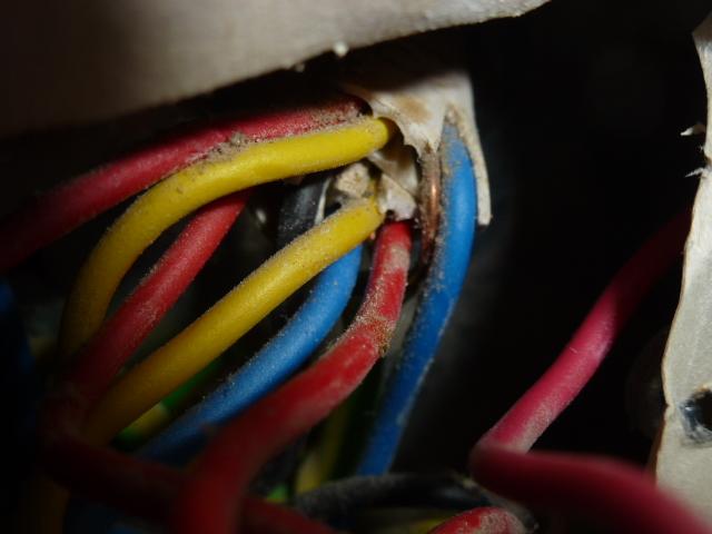

I've also included a photo of the main cable behind the switch
As far as I can tell this has multiple wires but I can't access sufficiently to see many.

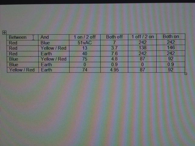

I have a multi-meter - image of readings attached. (1 refers to the left hand switch (outside light). 2 refers to the centre switch - porch light)
Tom
There are two blues in the second picture.
You must confirm that the one NOT in the first picture is connected to neutrals.
Your chart is not much help.
The voltages should be referenced to earth.
I.e. one probe on the wire and the other probe to earth.

One blue wire shown at the switch but I can see two blue wires in what you call the main cable - where does the second blue wire go?

Also (picture one) you should remove the link wire from the top right terminal and use it to connect both commons of the left and centre switches.
It won't make any difference but you have different supplies to each of the two lights.
Just to confirm - there is only one blue wire to the switch. The other is connected to black wires with a connecting box which was buried.

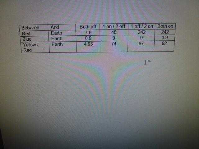

The meter readings between wires and earth are as follows. (These are for the left hand cable at the ceiling. The other cable goes to the outside light)
