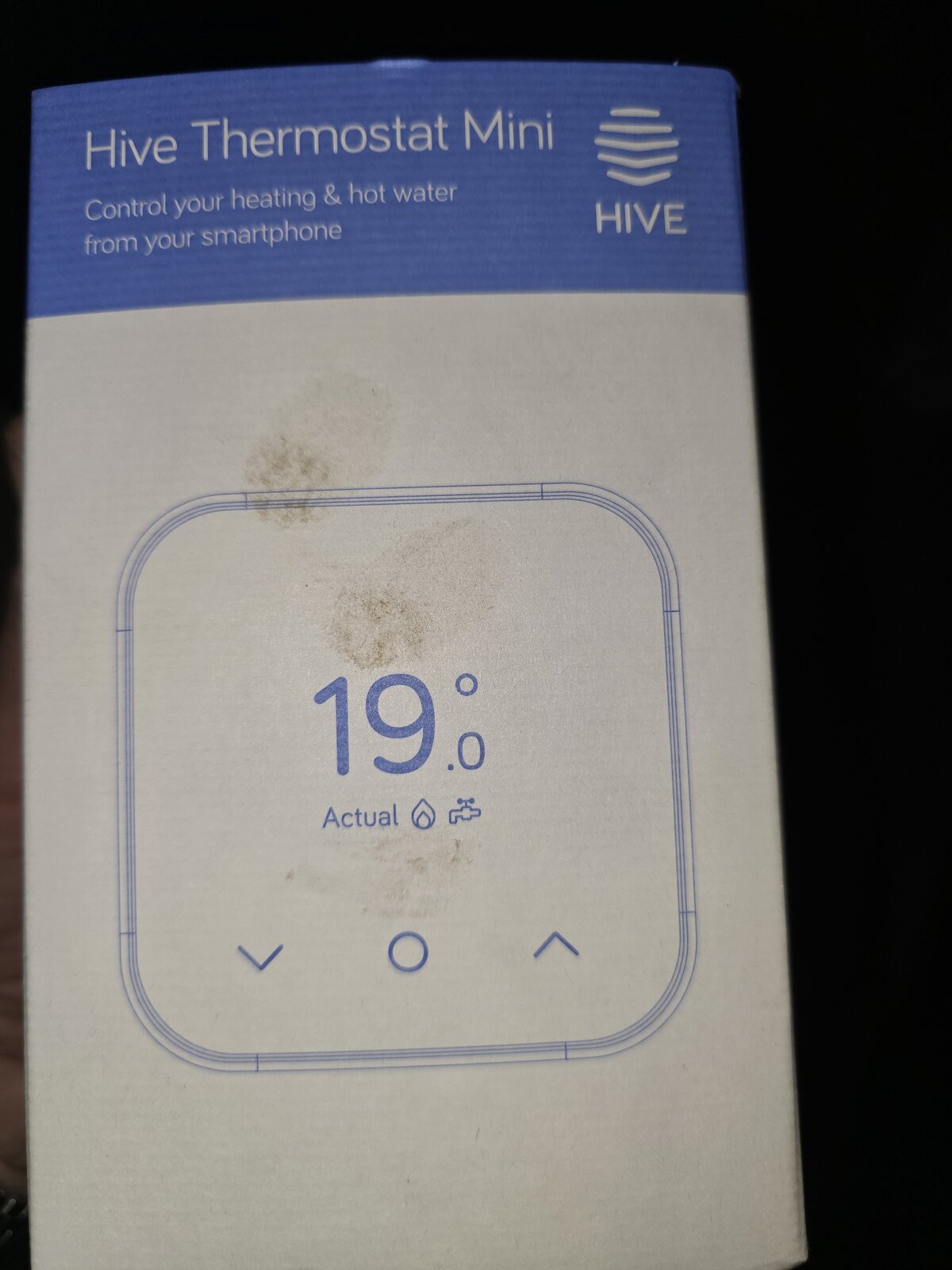

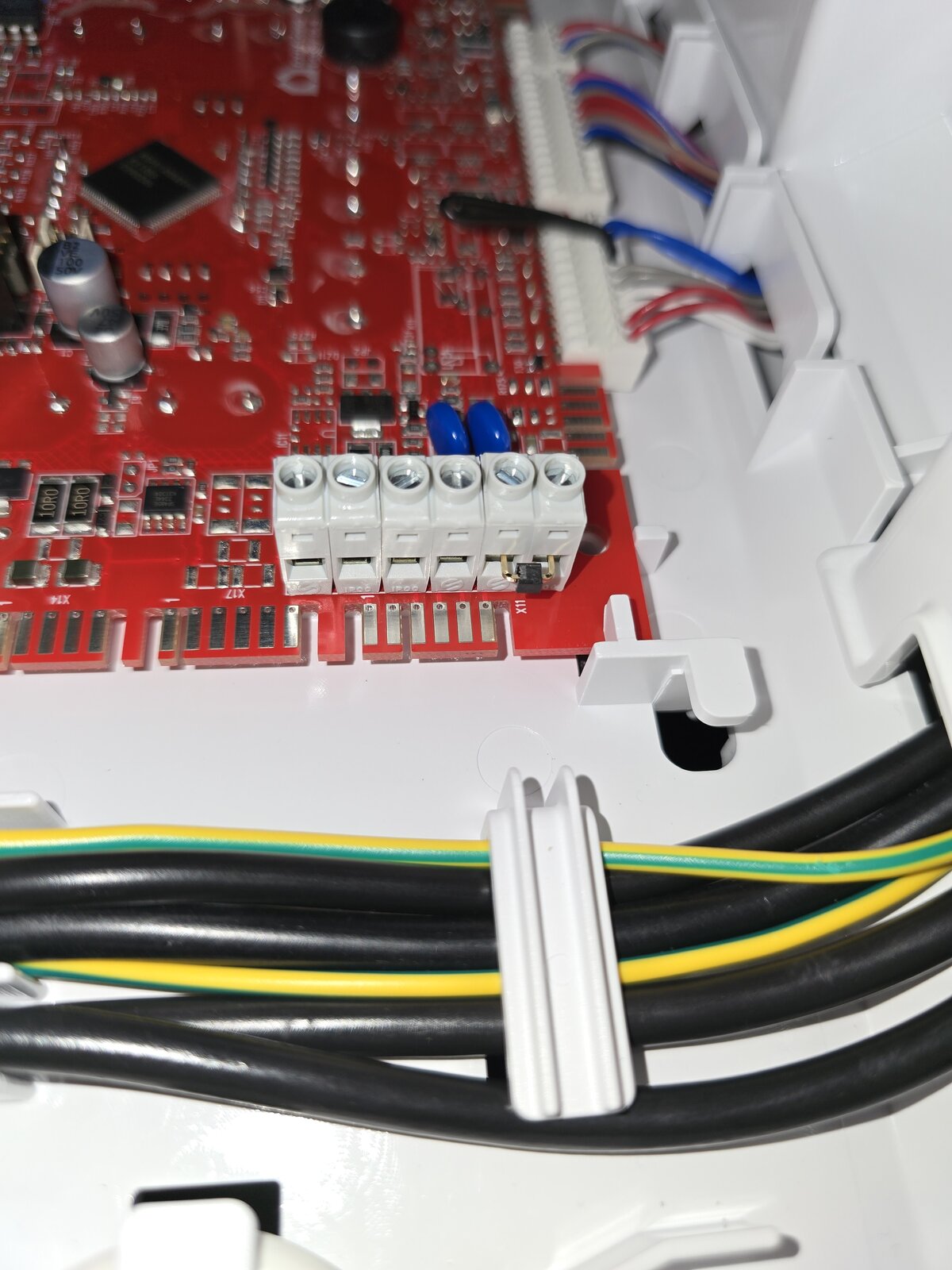

New here and sorry for digging up old post. Fitting a hive mini to a i29 c volkera, which terminals do i use and I need to remove the bridge from 1 and 2. The 2 wires from the mini do they need to be connected in any order 3 to 3 and 4 to 4 for instance.

As has been said throughout this thread...
The link wire needs to be removed from the TA terminals on X11.
You must only connect the TA terminals to the volt free contacts - terminals 1 & 3 (it doesn't matter which order), on a single channel Hive.
Do not make any other links on the Hive, that you may see in other wiring diagrams.
The Hive will then need to be powered from a separate mains flex, connecting to the L, N and earth terminals.
Thank you.
Have I been supplied the right hive unit. As it says, control heating and hot water.
Thank you.
No, I'm afraid not! - that's the dual channel Hive.
Connecting that to TA would damage the boilers PCB and would lead to expensive repairs.
You need the single channel Hive, or "Hive Mini for Heating".
