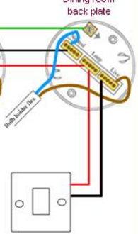

You have the 'dining room light' //www.diynot.com/wiki/Electrics:Lighting-Circuit-layouts

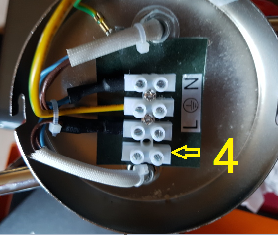

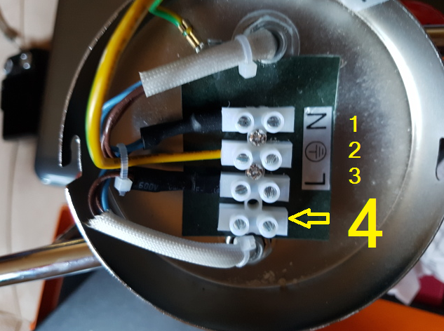

yes that pic looks like the same that i have, but what confuses me is the new light i have has six wires on the ceiling but
Disconnect the black wires one at a time when the light no longer works that will be the NEUTRAL feed from the mains. If you disconnect the remaining black that (should be the live feed from the switch ) that would be connected to the L on the light fitting, the reds should be connected together using connector block and do not connect to the light fitting.

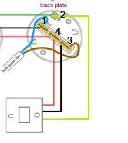

yes its the dining room light, looks familiar, so I figure out the black and red wire that goes to the switch, the remaing red and black goes to the new light i have, 3 connections only, red in, black in and earth yellow green in, what do i do with the red and black that goes to the switch ?
Oh come on, MROOD.
Edit - sorry, I misread that but no.
The two blacks will go separately to the light. One switched live, one neutral.
The reds will be connected together but to nothing else.
