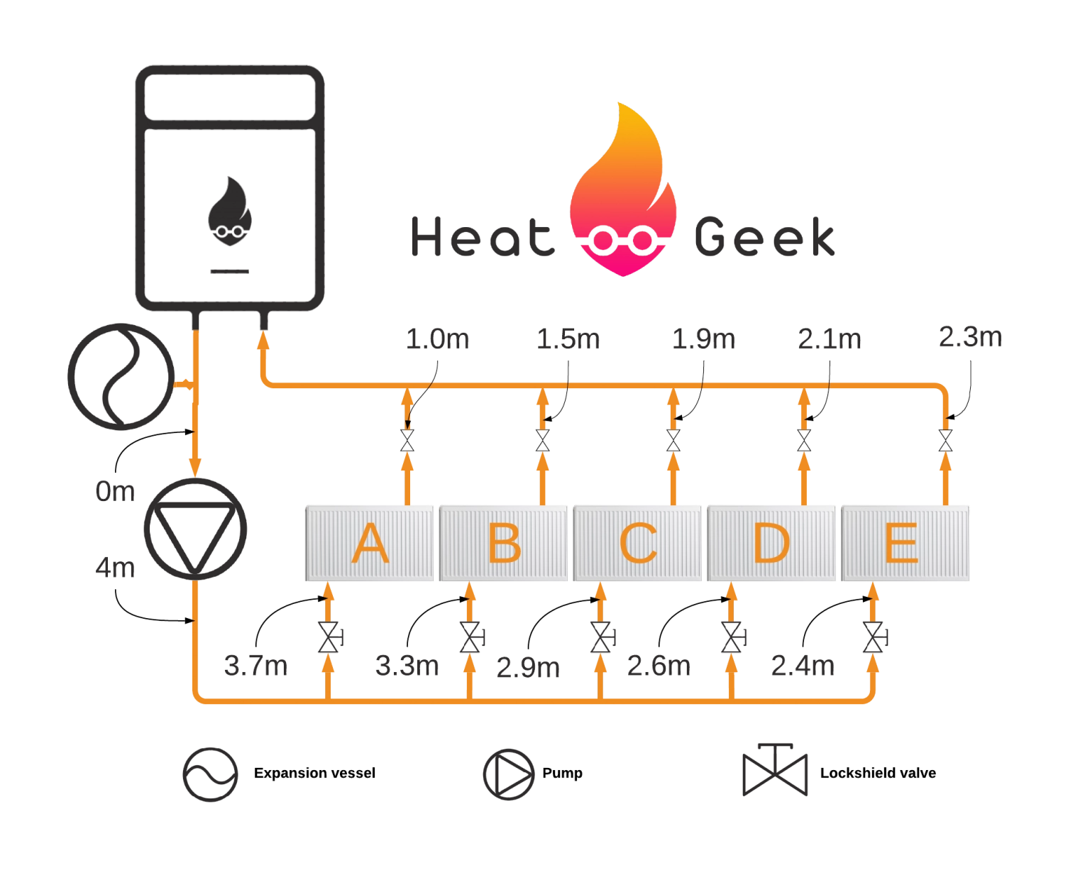

That confused me till I realised your sq root only applies to (1.0/0.3), not 7.1*60/1000. But shouldn't it be 7.2?
Presumably the 0.3 bar is the pressure drop across the TRV (not sure what you mean by dynamic head, that's usually V^2/(2*g))
Not with you. If it's 1.2 each isn't that 2.4m? Earlier you said 3m = 0.3 bar across the TRV, unless I'm misunderstanding you test.
BTW, TVR is (or was) a sports car :giggle:
No, I will correct this, it was 7.1LPM at 0.3bar. What I mean by the dynamic head is the head available at the TVR when flowing 7.1LPM, with no flow, the head, which I call the static head was 0.55M. The dP through the TRV at a flowrate of 1.43LPM should be (1.43/7.1)squared x 3M, 0.12m, TRV+L/S, 0.24M, not 0.44M (will edit above post).
The Heat Geek knows best??.
Balancing heating systems is simply making sure all the radiators or emitters heat up evenly
At least we have someone putting forth a basis!
It's a start.
But it's wrong.
It makes huge assumptions.
What you actually want is rooms heating up as quickly as possible in a system which is as stable as possible.
Quite difficult to do. Nothing to do with making the rads heat up in sync with the lowest common denominator.
