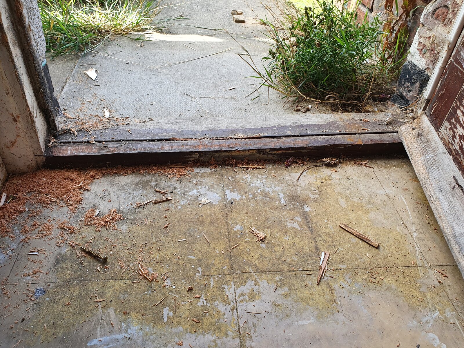

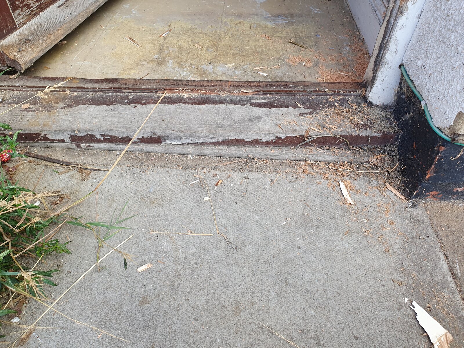

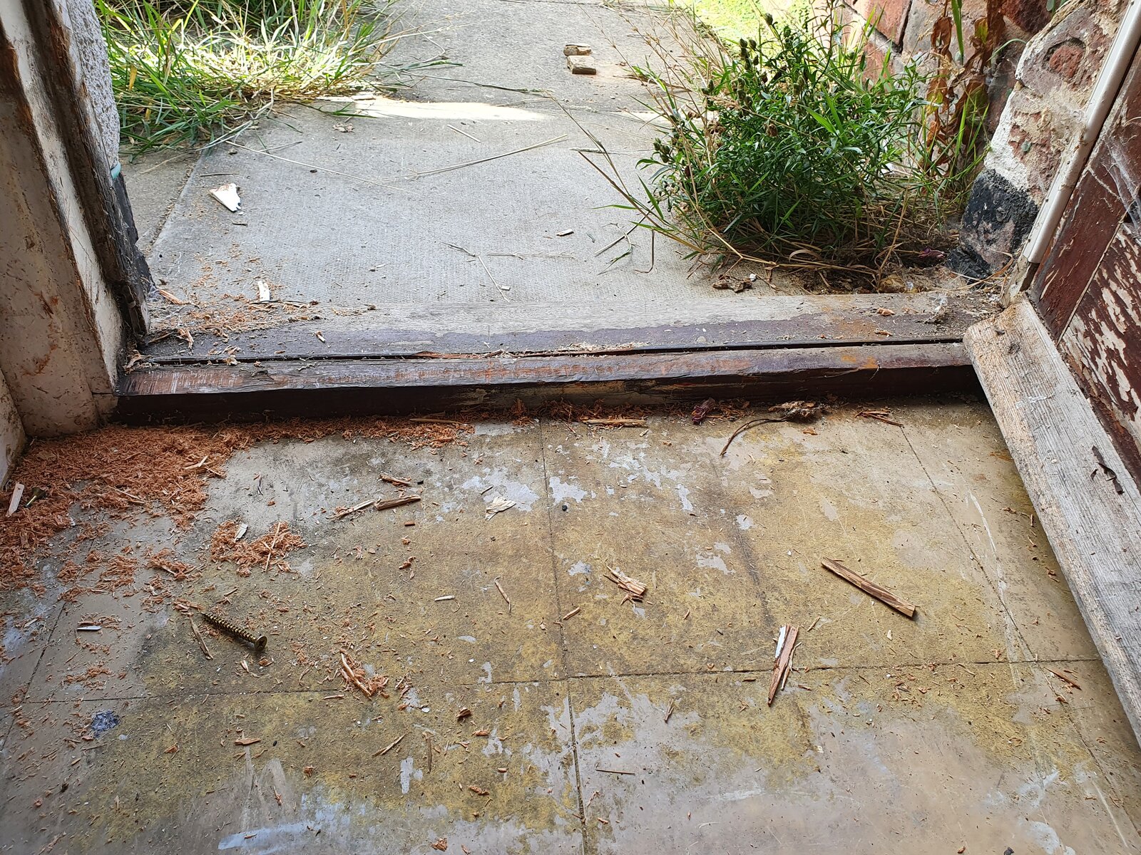

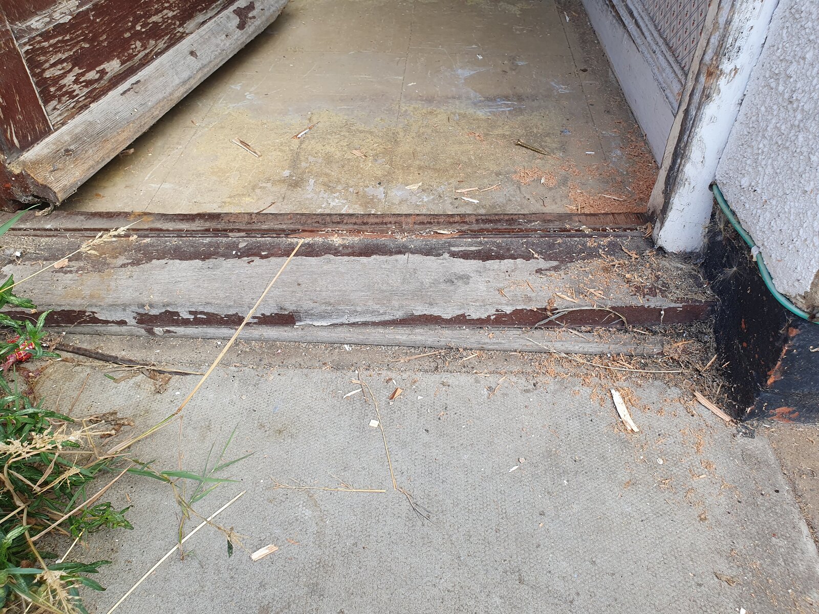

Here's some photos I've not removed the frame yet as I need to raise the step to allow the new door to fit can I do this

Once you've got the cill out, you can see what's what.
You might be able to build a course of brickwork, or concrete cill or cut down concrete lintel.
Obviously you'll be increasing the door height threshold, meaning you'll need to step over it when new frame is fitted.

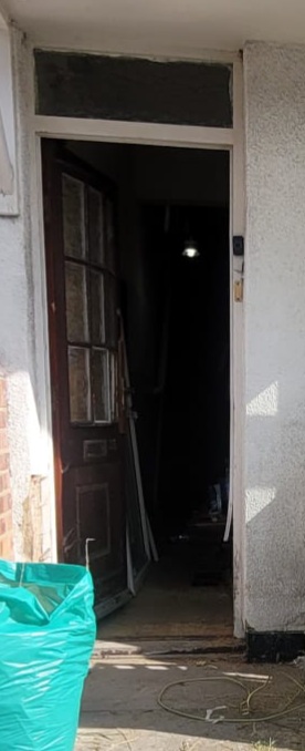

If they are at hand, can you post pics of the new door, and new frame, and a pic of the existing full doorway opening from sill to just over head/lintel height?
Not a criticism but seeing as you've got troubles with head height are you certain the new door width is correct?

Door opening wall to all 2360 x 920
I grabbed a bargain composite door brand new at 900 x 2085 the plan is to add a joining strip and a custom window topper joined on this I have no trouble with I have a upvc guy at my disposal and the door will be complete with a topper when needed
I need to raise the sill as the entire house is having underfloor heating meaning the floor height will exceed the sill

Atm I have added the best photos I have and a cropped imaged of the door
House is rendered but brick underneath the render

If it was me, I'd wait until you've done the flooring, you'll know where you are at, then install the door, and adjust the fanlight above the door to suit.
As previously mentioned the door cill can be brought up with bricks (halves)/lintel/undercill
TBH you should try to not increase the height of the doorframe bottom if you can help it, less is best.
At some point someone may need to use a mobility scooter/wheelchair and the higher your doorframe bottom the harder it is to get over it.
