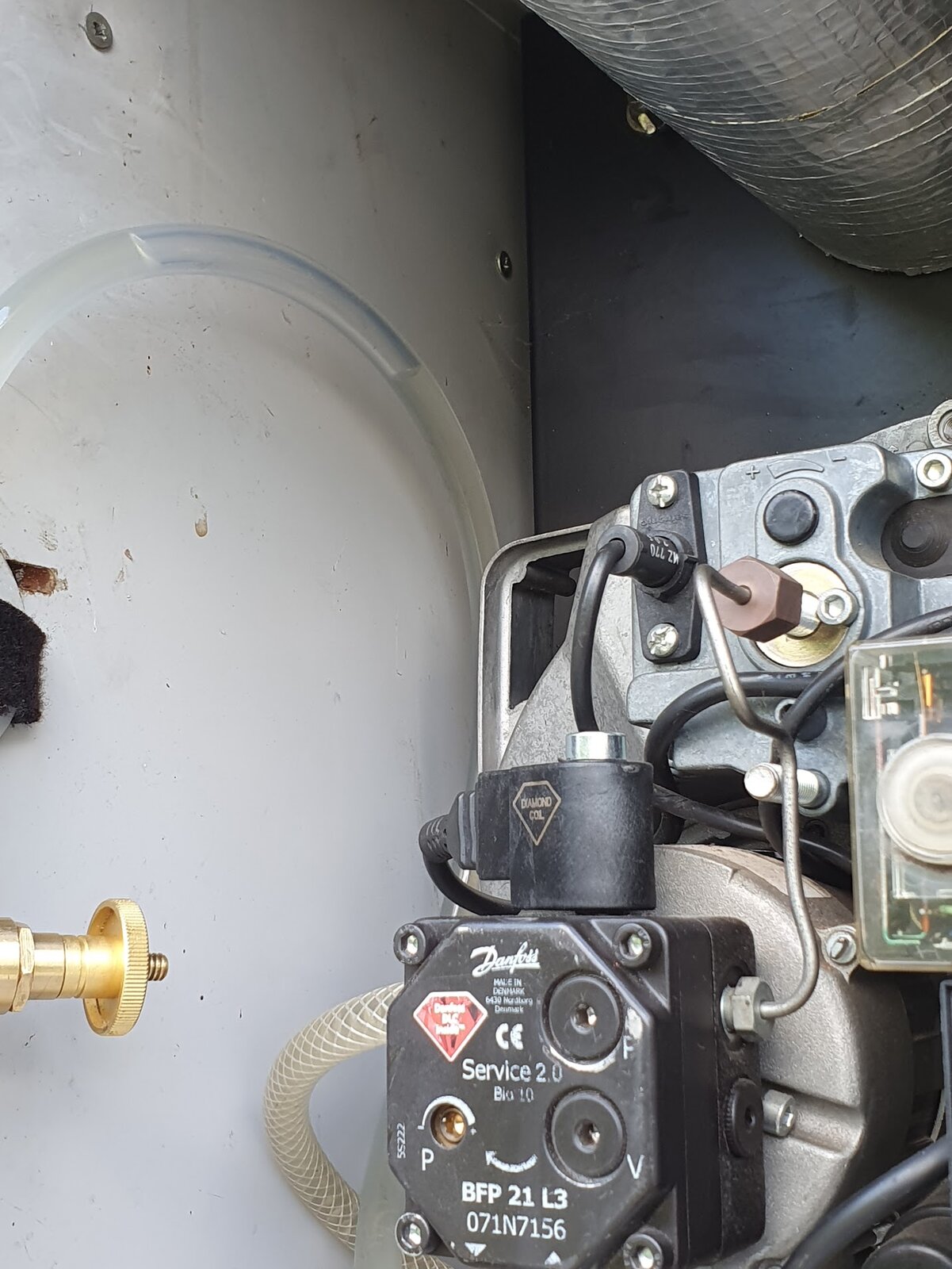

Not sure I follow. The boiler is on a 15min cycle with a min run time of 4min (CM67 thermostat).
The running sound is nice and steady. When I had a solenoid coil go intermittent you could hear the boiler burn sound vary. I don't hear that now.

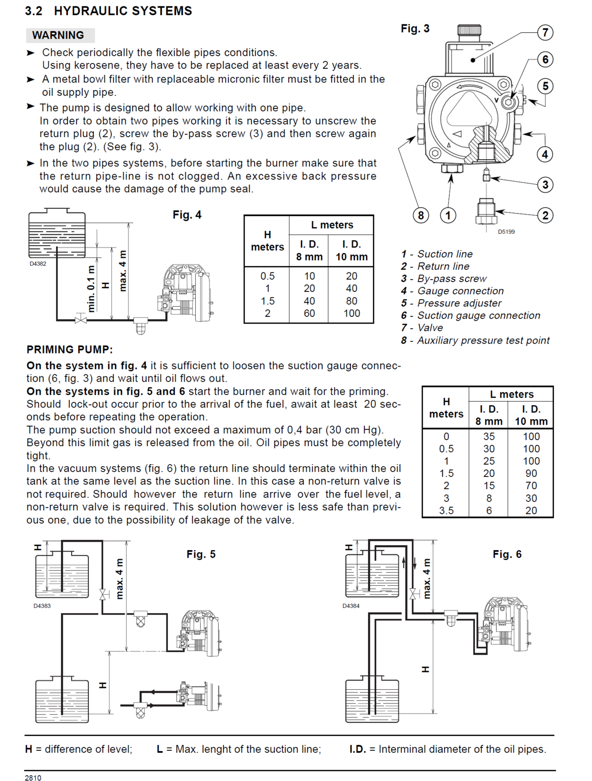

I haven't got a pressure gauge but the oil comes out under pressure if I open the air bleed screw so it doesn't look like it is struggling to get the flow.
Today's job is change the nr valve and see what that does to the bubble over the next few days.
