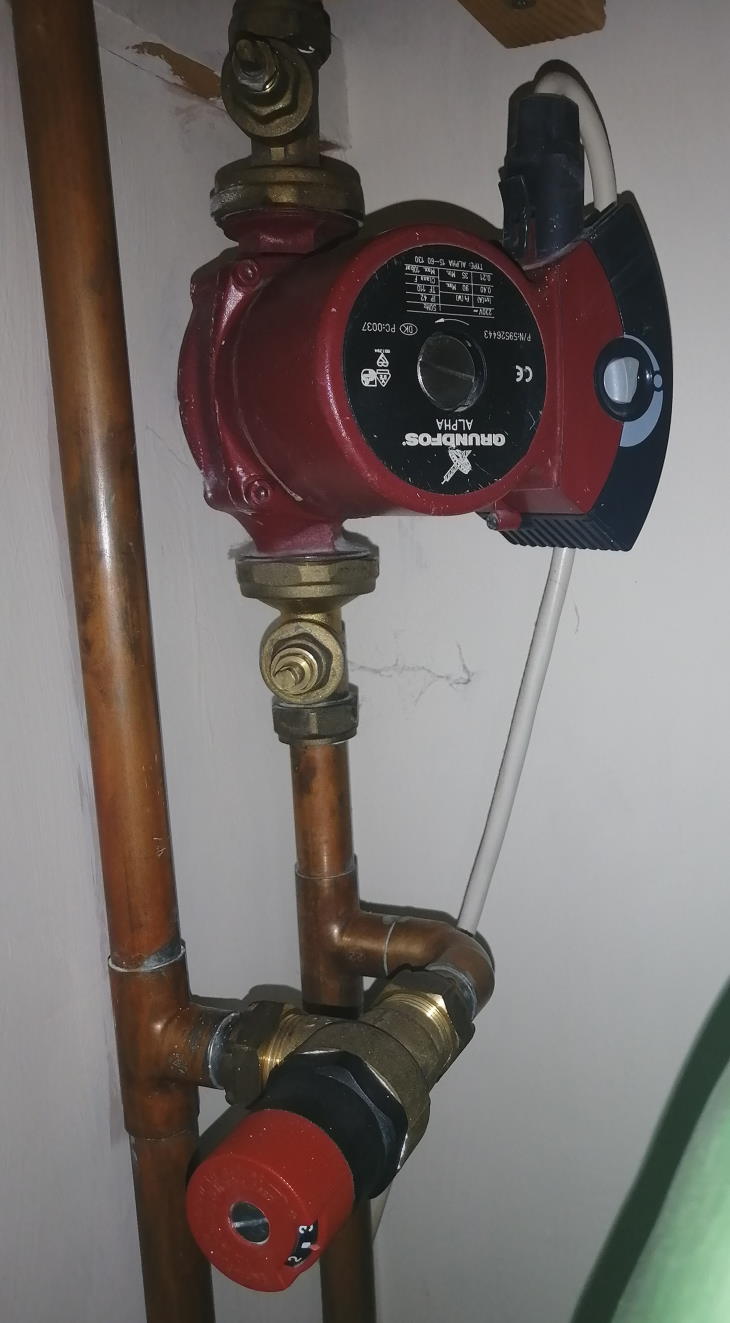

I’ve recently moved into a property that has an oil fired Wallstar Boiler (12/14 model ?) that’s around 20 years old. It has a good service record and ‘appears’ to be working.
When it is being used for heat, the boiler fires up and heats up the rads quite quickly. Once the rads are hot, it then cycles on and off (approx 2 mins on and two mins off). The pump is running all the time, there are no lights other than the amber mains neon indicator and the heat valves (S-plan system) is on. The rads stay hot all the while.
Having just moved from a house that had a new gas boiler, it too cycled when the heating was on, but not this regularly.
My first thought is the boiler has reached temp and it is waiting for the water to cool before switching on again. It does appear quite effective in warming the rads quickly. I've looked all through the manual and an unable to find any information on the way it operates normally.
The room stat is a Honeywell Smartfit. All the rads apart from the bathroom have TRVs which are fully open.
This may also be worth knowing. The pump I think is variable? Grundfos Alpha 15-60 130 with a Honeywell DU145 auto bypass valve.
I suppose at some point I will have to explore how to set the DU145 up with a variable speed pump, but that's for another day.
You can't set up a ABV using proportional pressure (PP) control but you can set it, to a fashion, using constant pressure (CP) control, and even though these A rated pumps have "traditional" 3 speed or constant curve (CC) settings, these behave partly in CP mode, right at the point where you require the ABV to open. I've never found out why they are designed in this way..
Its a bit unusual to install a ABV with a oil fired boiler as the heat exchanger contains 20/25 litres of water and will soak up the residual heat on boiler cut out without the Hi limit stat locking out the burner.
You can use the cycling as a reasonable indicator of the house heat requirements once you know the boiler output, by just monitoring the on/off cycle times for two or three cycles. If the average on time is, as above, 2 mins on, 2 mins off, the total cycle time is 4 mins, the on time is 2 mins so heat demand/boiler output is 2/(2+2), 50%, a 14kw boiler will be running at a average of 7kw, if the on time is 1.5 mins with 4.5 mins off, boiler average output is 1.5/(1.5+4.5) or 25%, heat demand/boiler output of 3.5kw with above boiler.
