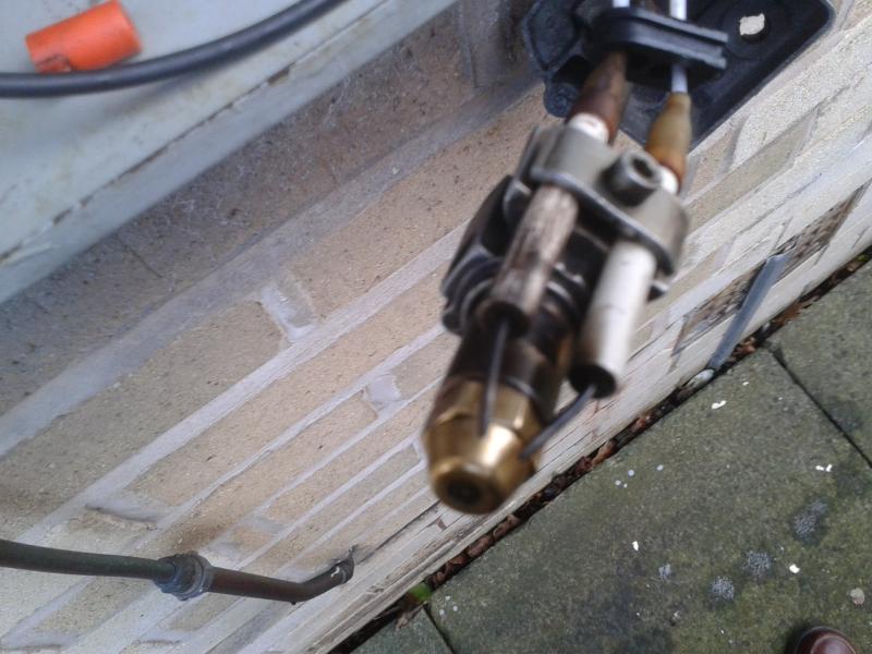

Thanks for your reply. The tip of the electrodes are about level with the front of the nozzle. Should they be slightly further back? I'll try to upload a photo soon.

Generalising, the tip of the electrodes are flush with the end of the nozzle, and the gap between them around 2.5 to 3mm.
The draught from the fan blows the spark into the atomised oil spray.
A couple of things to check......the spark should spark, naturally enough, between the electrodes. However, it's not unknown for the spark to jump onto the nozzle or indeed the blast tube if things aren't correct.
A dud nozzle may spray the oil away from the electrode arc, poor oil pressure may cause insufficient atomisation.

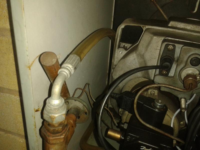

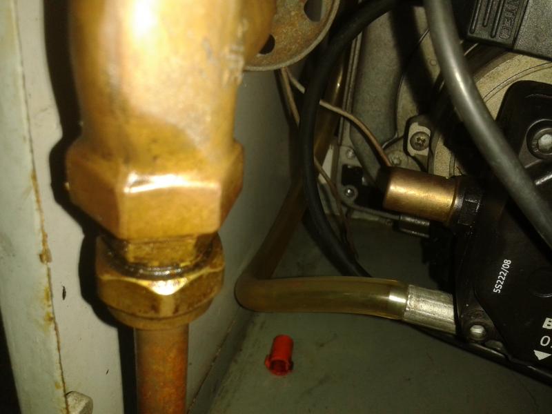

Despite the slight dampness at the joint it can (hopefully) be seen there is no air at all in the supply.

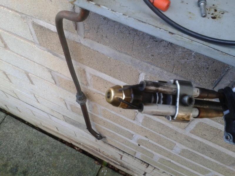

Hi John. Yes I'd noticed when testing in free air, when I widened the electrode gap to try to give a bigger spark, because of the kink in the electrode it puts them nearer the nozzle, the spark was then alternating between electrode - electrode and electrode to nozzle, so I sorted that.

What size gap have you between the electrodes.seems wide in the photo.
Should be about 3mm
