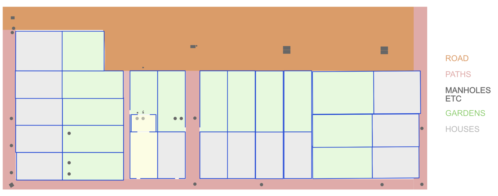

I lifted the Osma. Give or take a few degrees the pipe appears to be facing towards my neighbour. I've also gone a little OTT and plotted all the manholes e.t.c. I could find nearby. Does that map make it seem likely mine is a private drain and my neighbour's is the shared sewer? Mine is the yellow / green property (and where I 'think' the manholes would be located in the orangery).

Looking at that I’d guess they would run left to right from your house into the footpath and that they are private drains.
Just a guess though.
It is a private drain. Managed to check yesterday :)
