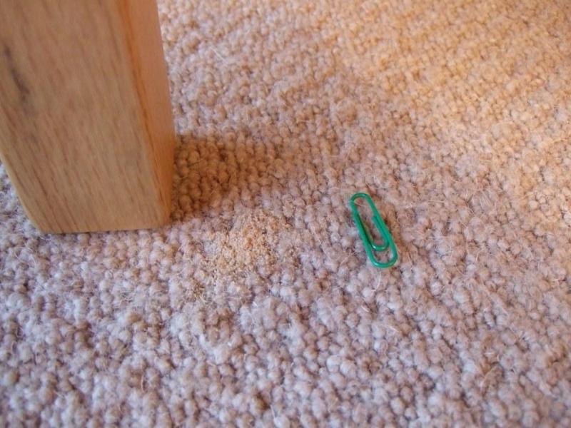

Earlier in they year my wife noticed a clicking sound from a dining room chair - bought late 2005.
All advice was to stop being paranoid - it's heat expansion and contraction.
The manufacturer said all their wood is treated.
Anyway the chair went quiet....for the last couple of months at least.

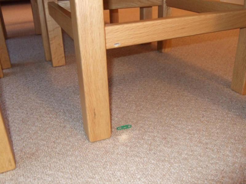

Today my wife noticed this (see pics)
We’ve found no other holes and heard no more noises.
I’d like to think the insect was in the chair when we bought it and that it was a one off.
(The dining room floor is wooden)
What do you think?

That beetle must have been on steroids, the timber looks like beech, was there a pile of dust under the hole when discovered?
I think I would be quarantining that furniture to see if anything else developes.

Yes there was a pile of sawdust under the hole - one of the pictures was meant to show that - will try to improve tonight.

It got in there by being laid as an egg near the surface of the wood, probably when it was slightly softened by damp. In a wood pile perhaps. The egg hatches and starts to eat the wood, and gets bigger and bigger. (You have read "The Very Hungry Caterpillar" haven't you?)
In the meantime the wood has been run through a saw, planer, morticing machine and spray booth.
So when grub comes out, he was probably a bit suprised.
Anyway, his/her job then is to find a mate, and a nice soft damp bit of wood......

Would I be able to see an entry hole? Then again it could be covered by the chair's construction...

I wouldn't expect you to find the entrance hole - it would be very small to start with, and I don't know how far these things bore before coming out.
