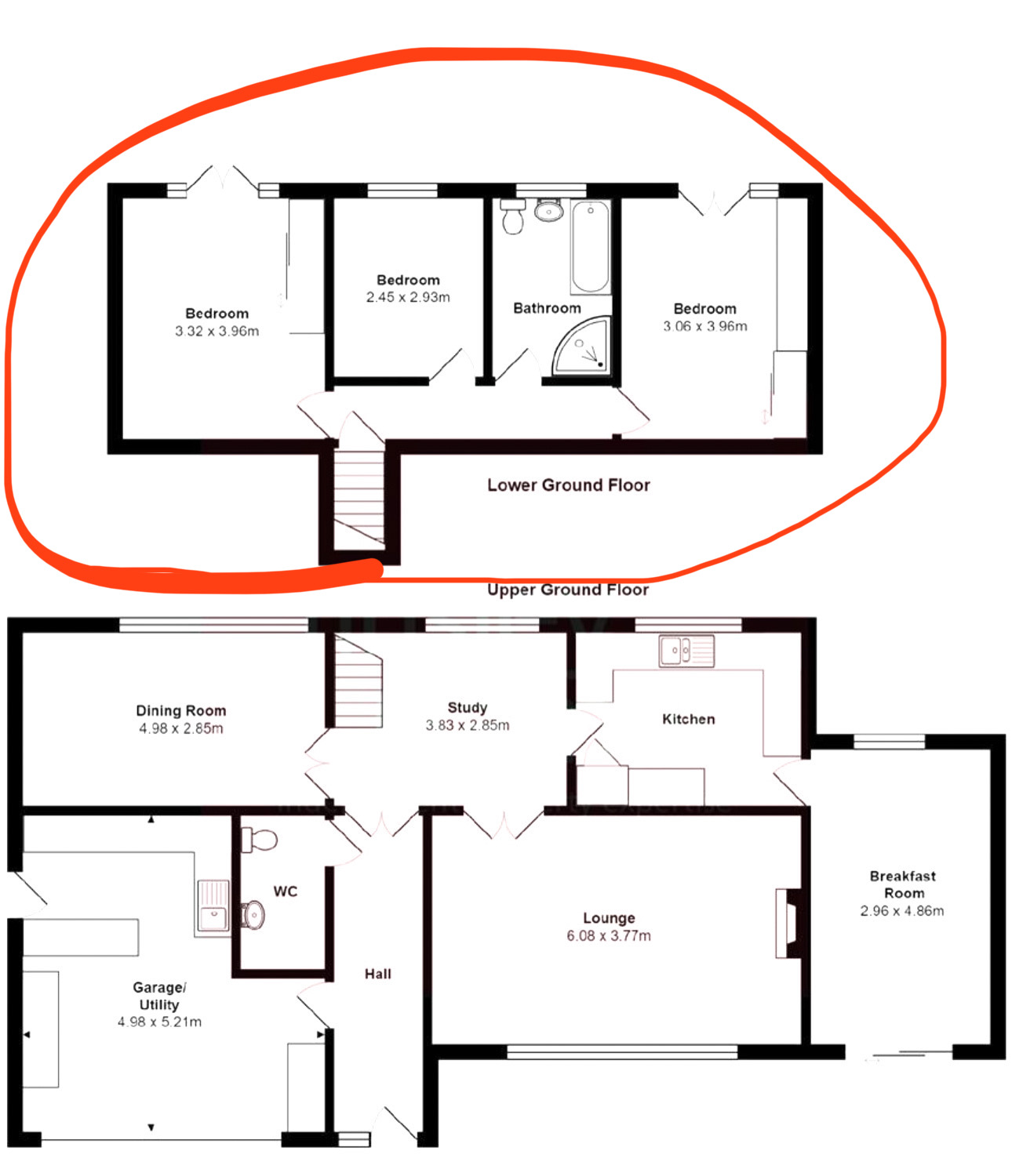

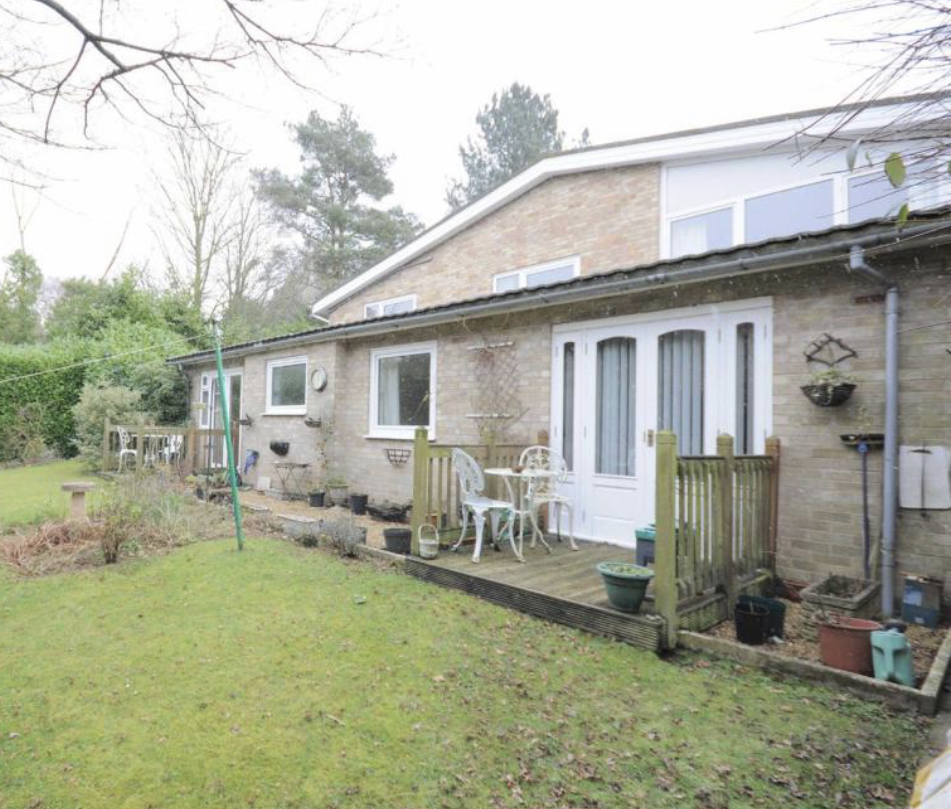

I’ve attached a plan and an old estate agents photo of the back of the property showing the lower floor to hopefully demonstrate a bit better as it’s an odd property. The lower ground floor rooms (circled red) are offset from the main floor… it’s like a bungalow but the rooms are on two levels.
The area circled blue on the map is where we know there’s a leaking waste pipe.

Get that waste pipe fixed before thinking about anything else. Can't see a blue mark though.

Sorry I must not have saved the blue mark. ‍♂️The leak is under the dining room though.

I'm having a similar battle here, I've temporarily re-routed the downpipes completely away from the building into the garden, as I suspected the underground pipes might be seeping into the foundations. Old soakaways can be a pain in the arse even without a downpipe, if the ground gets wet then the water can go backwards from wherever the pit is, so they actively extract water from the ground and bring it towards the building. If there's a leaky old pipe then it can seep through the wall and under the floor.
Also check the outside ground levels against the floor level. I've been reducing the garden level in ours, soil tends to naturally get deeper over the decades so sometimes needs a spade depth removing to get things back to where they should be.

Thanks for that. The leak is above and behind the bedroom which is the worst of the rooms so that’s definitely a possibility. But it’s also the bedroom that gets the least sunlight and so it’s the coldest room too. We’re waiting for the waste pipe to be fixed under the house insurance right now so it’s not a quick job but hopefully that will be done soon.

It’s definitely interesting. It’s not self-build though. The estate is all architect designed and I can only imagine the architect was on drugs… we have houses on the estate that are almost like cottages and others that are brutalist cubes. And there’s some questionable design choices in places too so god only knows what surprises await us when the renovation starts.
