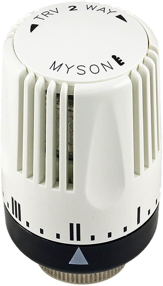

So TRVs are supposed to be on the flow line not return? With the exception of bidirectional TRVs I read. My TRVs are Myson brand 2 way TRV. Is that bidirectional? How do you know which end is flow and which end is return? One side heats up quicker than other side when boiler is turned on is that the flow?
That is the flow end :)
Thank you. So basically I either need to move the flow pipe that's going into the left to right to go into the TRV and move the return pipe to the left. If pipes don't move then I will have to remove the valve at the radiator openings and swap them around? Do i use PTFE tape on the thread? I have plastic pipes going in like the pic below, are they push-fit? I'm assuming I press the sleeve in towards the valve and pull the pipe out? Are all the fittings re-usable? I don't need to replace any seals or anything?

Not necessarily, it could just be a faulty TRV. Take a photo of the actual TRV.
just turn the valve so the sensor is now horizontal, or just remove the sensor as a temp measure
Here's a pic of the TRV's that I have:

TRV on the wrong end? Seriously? it's been like this since the property was built 11 years ago.
...and you now have a shiny new pump that will pump the water around your system much faster, exacerbating any TRV rattle problems.
Look up Bernouillis theorem, and the effect of fluid flowing through a restricted orifice (such as a nearly closed TRV)....Forget what setting it's on, the temperature of the room determines the orifice gap.

Thank you, these Myson trv says 2 way and I read that apparently they work on both flow and return. But regardless I think as good practice they should have installed them on flow. The problem with this noise issue is that my property was a new build around 11 years ago and this noise issue only started few years ago so for a good number of years it was silent. So if it was the TRV would it not having this noise issue all the time?
Although that one time adjusting the TRV slightly made the noise stop it didn't last for long and now when the noise comes, regardless of what I do to any of the TRV it still makes the noise. TRVs are on max open setting and the noise is coming from the boiler itself. Does TRV related noises come from boiler?

It sounds to me that as more and more of your TRVs shut down the reduced circulation is resulting in the differential pressure across the remaining valves becomming excessive leading to noise.
Although the boiler contains a spring loaded bypass valve that will open once the pressure is sufficiently high this is more for boiler protection.
You might consider fitting an external auto bypass valve across the flow and return.
