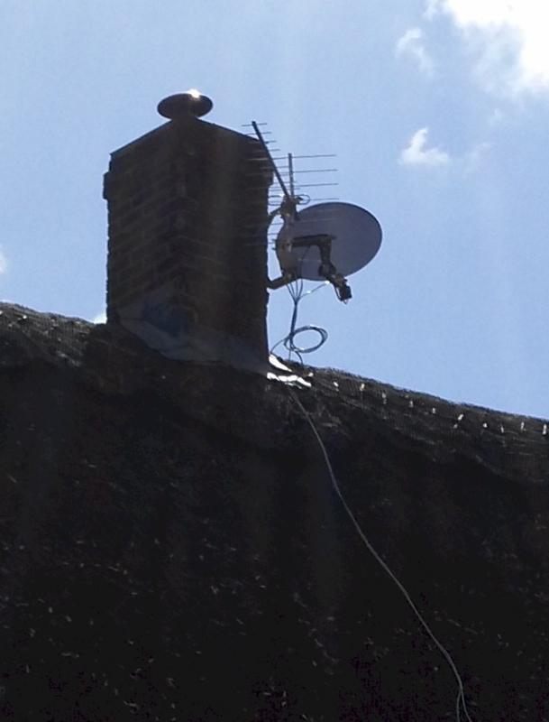

No problem...for info swapping the aerial fixed this for me - the design of the original aerial in the pics earlier in the thread was the culprit.
If you wrap the pole with cloths line and secure, it will break up the turbulence around the pole reducing movement [many chimneys have spiral flutes around them for the same purpose]
Ballsacre, what was the outcome of your planned rectification to the aerial you thought was most likely causing the humming noise? I have the same problem and have been searching for the source for several years! It had occurred to me that it might be the aerial ... Sleepless :unsure:
In the end I didn't I have to remove the aerial. I just got the local TV guy to reduce the length without loss of signal. No more humming. I've been sleeping without interruption ever since!

Basically exactly the same as the picture in thread above although the actual pole is about '36 inches higher.'
What i am failing to understand, is why the pole would or could resonate sound for 18-24 hrs day and night continuously ?
I actually think its a sound created by power,humming/droning or perceived by me as, or maybe infrasound travelling through to me from a good distance away.I've even suspected someone maybe running a drug farm nearby;and i am sensing fan hum being eminanted from there.
It may be nothing to do with the mast, hence request for pics.

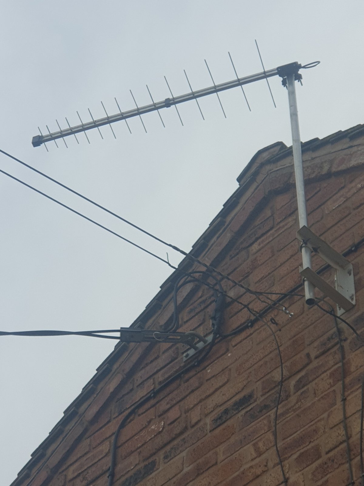

I had the (hellish) issue for a couple of months before finding the solution - since swapping the aerial it's never reoccurred though.
I can imagine that the length of the pole in the other person's post could contribute, as the hum could be associated with resonance, which the pole length influences. Similarly the design of the aerial itself could influence the amount of wind being caught, hence vibration/resonance (below is a picture of the new design I had installed).
Resonance is associated with the natural frequency with which the structure vibrates (https://en.wikipedia.org/wiki/Resonance). Altering the length of the pole would alter this natural frequency, so there is a sound scientific reason why that might help. For info, mine made the noise even in both high, and what I perceived at ground level to be low, winds; although it was particularly noticeable at night when the rest of the house was silent.
In my case, comparing the before and after pictures, it does appear that the new pole is slightly shorter than the old one as well - I therefore can't tell you definitively whether it was the pole or the aerial, but replacing both eliminated the problem for me. Hope you get it fixed soon.
The pole has an open end effectively turning it into a single note flute . Get similar problem from car roof rack if I don’t seal any gaps .
