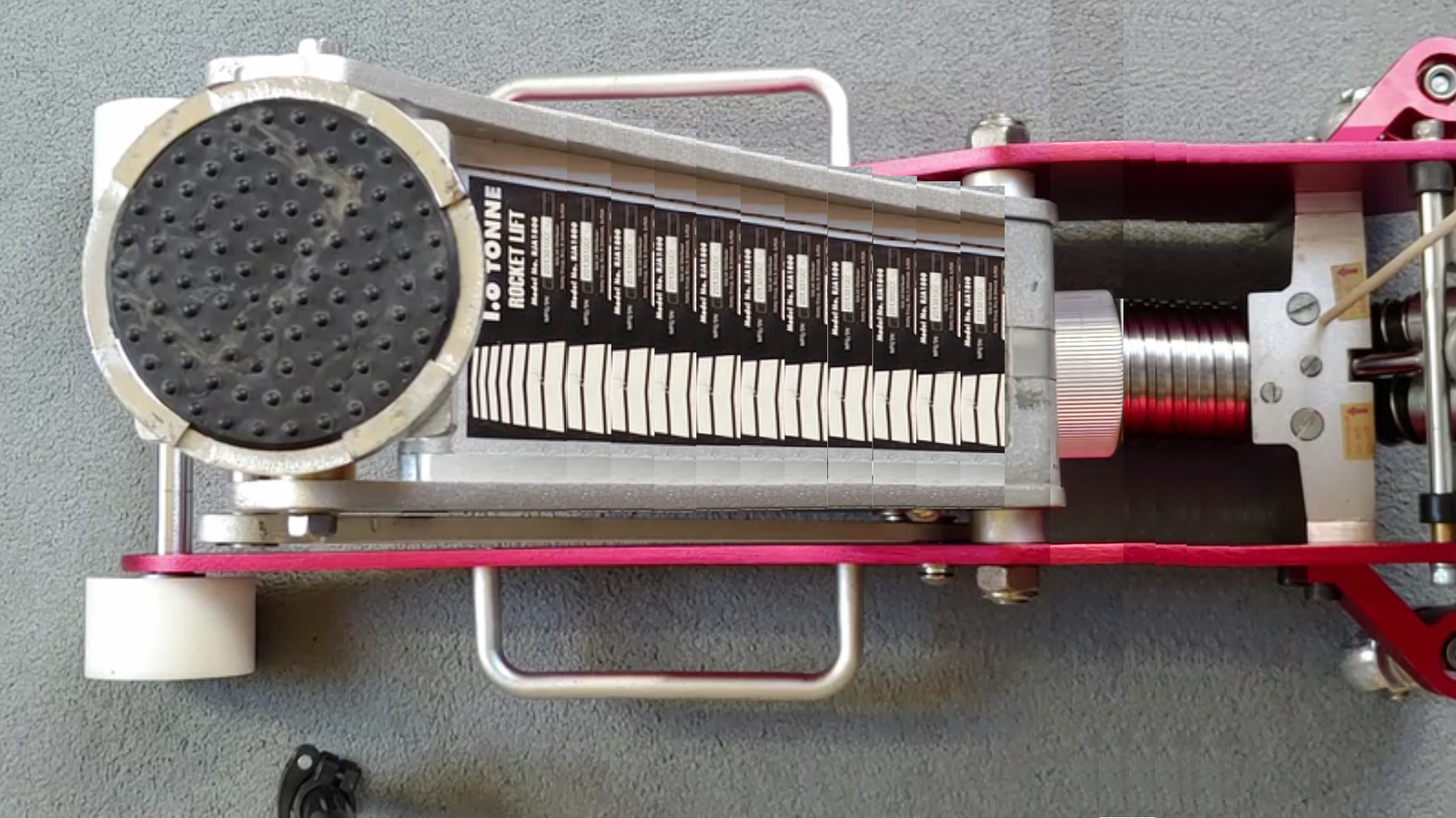

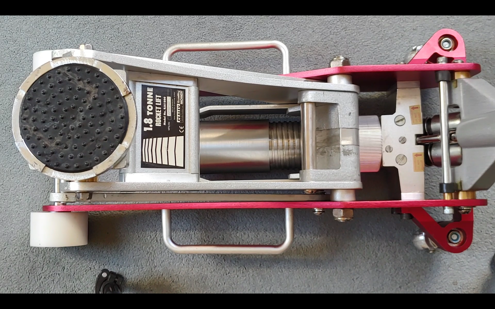

Slightly off-topic question for DIYspanner ... and all those who use trolley jacks :
Would you buy a mechanically-lockable trolley jack like this ?
The finished retail unit would have an additional 4 inches of chassis length (between the lifting-arm and the pump) - so you could lock it from behind the lifting arm ....
... rather than through it -
It looks like a good idea but it's too much faffing about for me so, I'd rather just use axle stands.
I think there will be people who forget to screw it up and will get hurt.
I also believe the triangular foot of an axle stand would be more stable.
Agreed - on older chassies with chassis rails and pinch-welds that run the whole length of the sill ... but where do you put an axle-stand near the jack on modern car chassies with a single jacking point at each corner ?
It makes secure axle-stand placement a time-consuming faff that's often a compromise - not least because the torque forces placed on an axle-stand when a car is lowered onto it can't be resolved because the stand has no wheels ... and the stand ends up on two instead of three feet, whence you have to jack the car up again and adjust its position to make it stable.
Two locking jacks on the same side of the car would make a very stable platform.

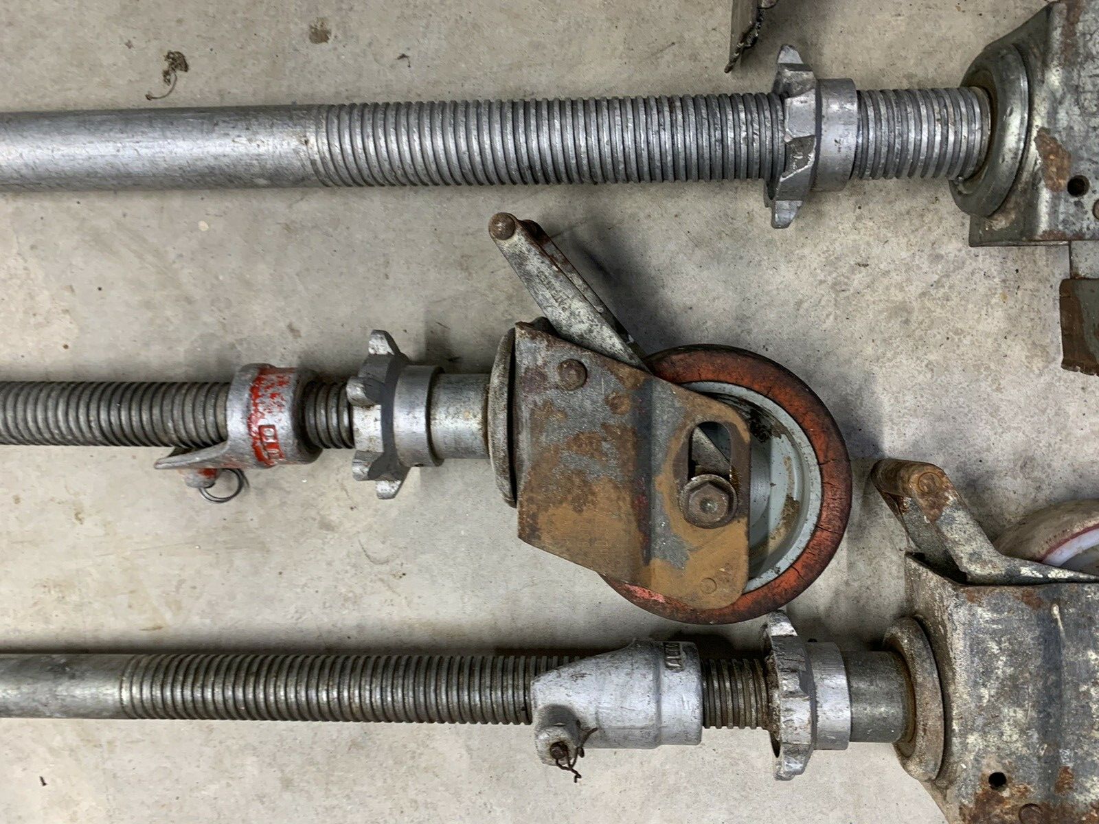

Regarding the trolley jack, the locking collar threads may get damaged and putting your fingers in seems a bit iffy to me. Perhaps speak to engineers from BSI and get their opinion.
Unlike the dense, tight-fighting, V-cut threads of clamping fasteners such as nuts and bolts - the locking components have the same coarse pitch and loose fit as the adjustable alumInium scaffolding legs below :
They're square-cut threads (for high-load applications) - and the coarse pitch and loose fit will tolerate dirt and minor damage.
