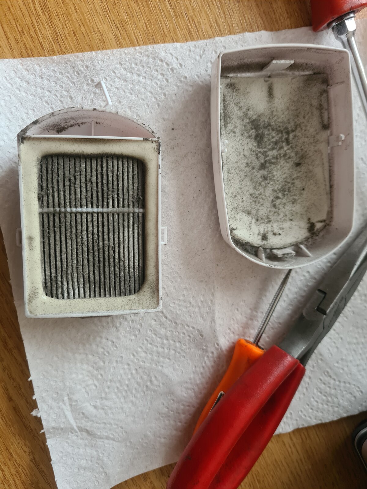

If you open a filter cartridge for those Force 8 masks you'll find that they contain pleated paper fibre filter, so basically if you self test the seal, then try breathing normally through the mask, the filters are considered to be blocked when your breathing is laboured. I get anything from a few days (heavy demolition of timbers with dry rot) to maybe 6 weeks (normal sawing of softwood joisting, spars, rafters, etc - say 2 to 3 hours per day) out of the P3 filters. Continous sawing of MDF or plywood and I'll get 3 to 4 weeks out of filters. Note that I use vacuums attached to saws as much as is feasible (not 100% of the time, though)

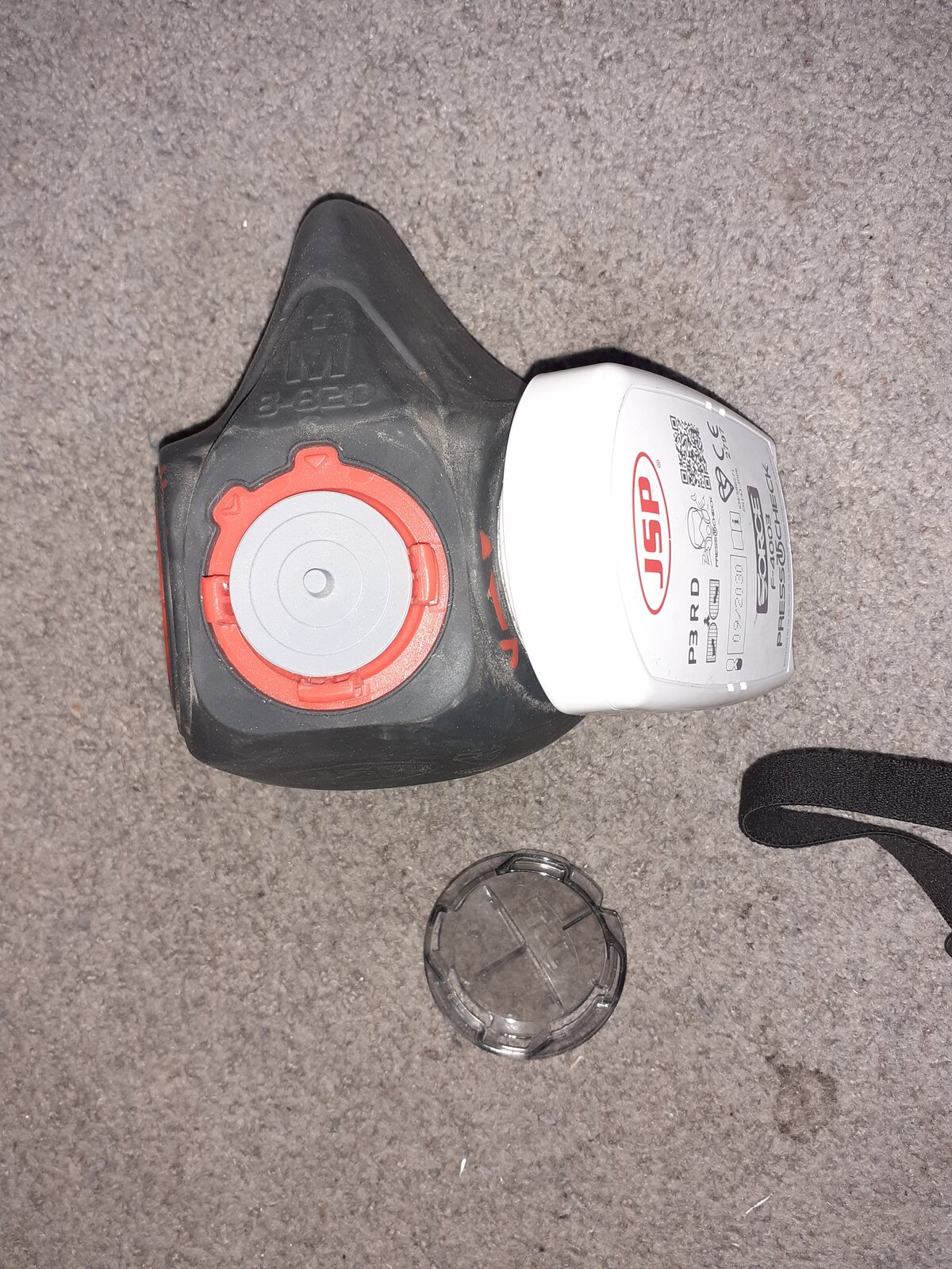

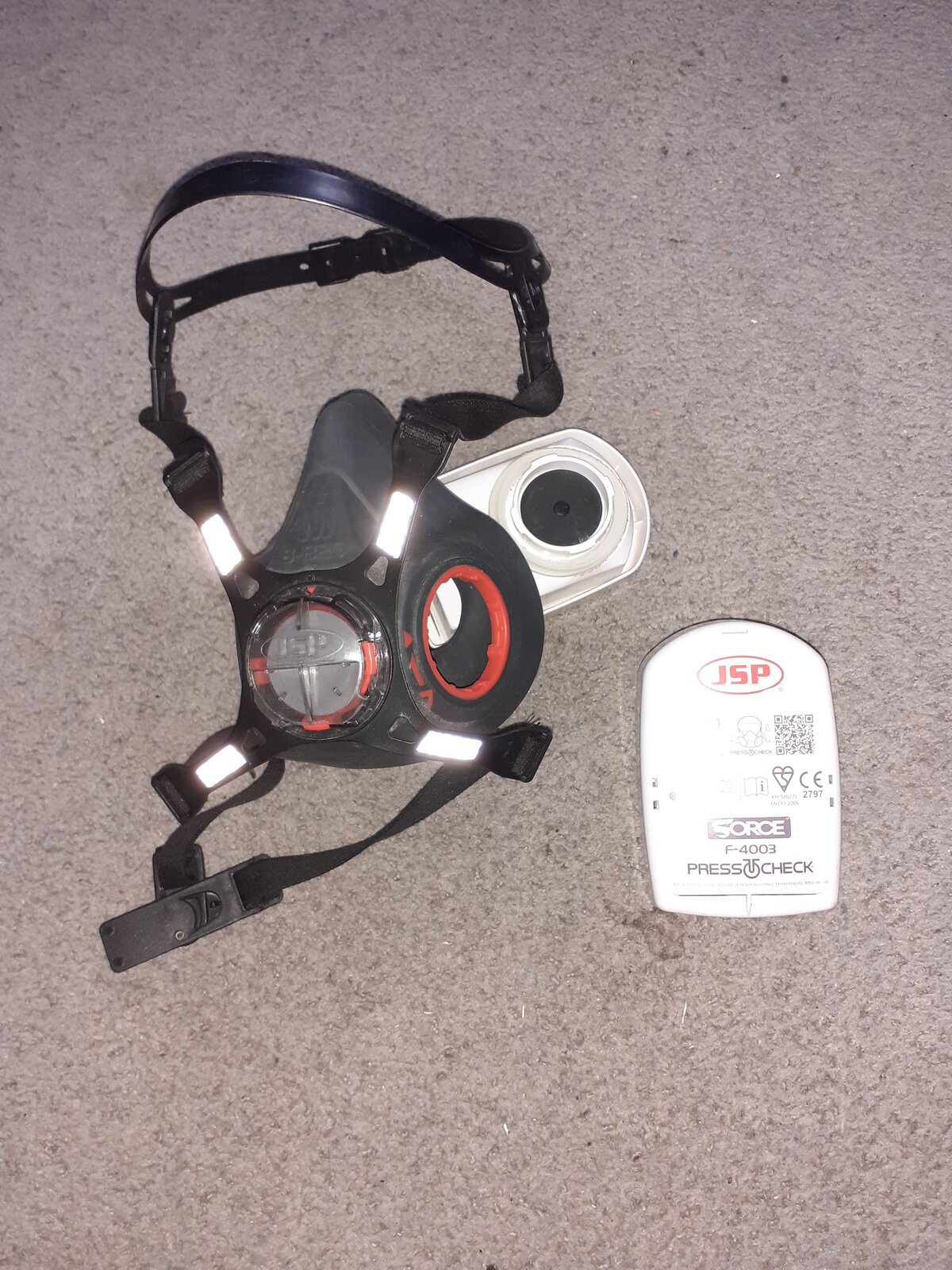

...mask and filters, though I tend to have the opposite problem - lack of use. Being more of an 'occasional' user my main concern is more that over time they will build up bacterial and/or fungal contamination, though the one-way valves should prevent breath/water contamination. Even so, probably should change the filters after a few months as a precaution.
Firstly the filters for Force 8s used to be about £8/pair (P3), so not too expensive. (Edit: checked prices - currently just under £9 at SFX)
The main part of the filter mask:
Is made from rubber and plastics and believe it or not mine goes through a low (cold) temperature wash in washing machine (sans filters, but together with my hard hat - no fabric conditioner, though, which makes everything feel "greasy" and don't wash filters as that ruins them) in the delicates bag maybe once a month (more often if heavily contaminated). At the end of a working session I almost always give it a spritz of disinfectant multi-surface cleaner (like Dettox) and a wipe down with some tissues inside and out to get rid of condensation from my own breath. It takes all of a couple of minutes.
Note that you can also remove the one way exhaust valve cover for cleaning, a 1/8 turn twist connection:
For longer term storage I think all you need to do is remove the filters (1/8 turn to twist off), clean and dry the mask body and store it in a plastic bag. I'd wipe off the outsides of the filters with a tissue and store them in a second plastic bag, possibly with a sachet or two of silica gel if you are concerned about fungal growth - a combination of the highly absorbent nature of the filter material inside the cartridges and the dessicating effect of silica gel should make it impossible for fungus to be activated (all fungii need water to grow, although many seem able to remain dormant for long periods even in harsh environments)
Store these items somewhere cool and dry as heat and UV light both degrade rubber and you should get a long life from them
