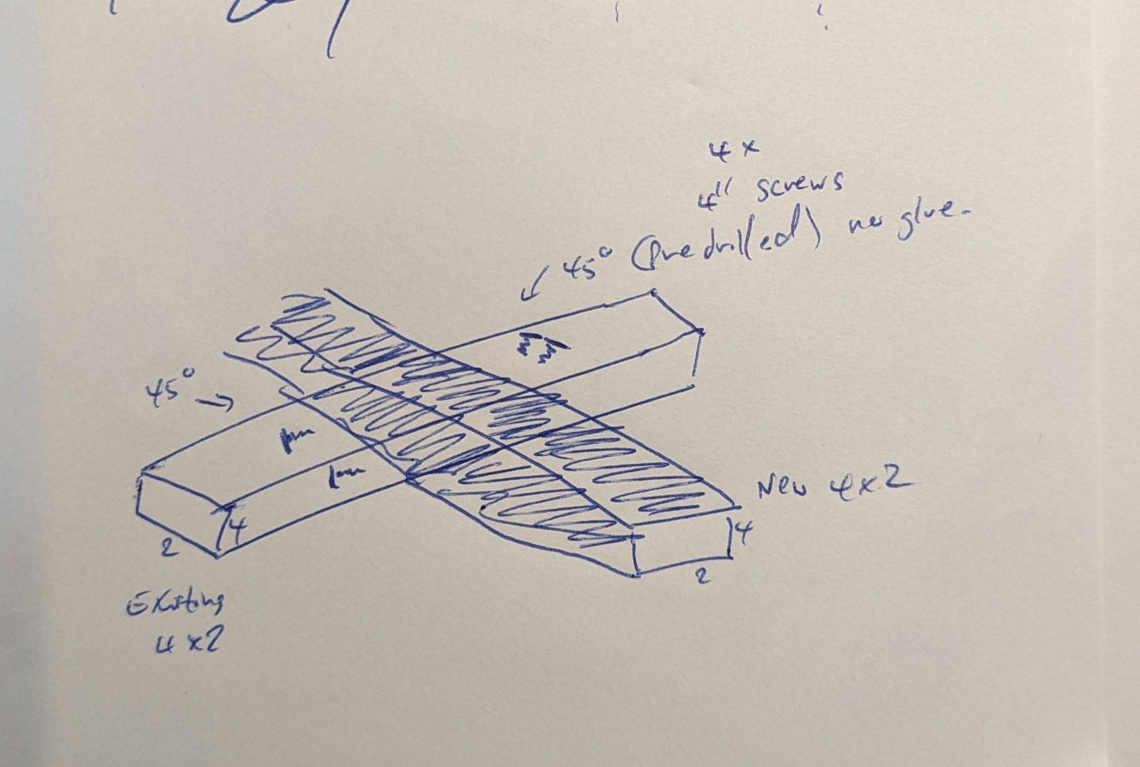

After a lot of had scratching and debate, I've decided to go with the framework using 4x2s.
This will give 200mm insulation everywhere, and I will lay out an extra 100mm to unboarded areas. The house is cold, but this should be sufficient to slow down the rate of heat loss.
New framework/battening
Please see attached terrible drawing.
New 4x2s C16 (at 400mm centres) across and over existing 4x2 joists (these are @ approx 400mm). No glue.

2 either side, 30-45 Deg skew to secure to each other.

Your diagram looks like you've got the 4x2 lying down so the top face is the 4 ?
Why not the "just lay rigid insulation over the existing timbers and board atop it" route? Vastly easier than dragging timbers up there
Not looking for a pretty job
You don't need to faff about using spacers to level up a boarded floor in a storage loft. The boards will deform to follow the shape of the joists they sit on
I personally would put the boards long side at 90 degrees to the supporting joists they are screwed to
I wouldn't bother with any floor covering either; board edges aren't going be distinct if you TnG and only a couple of mm at most if non TnG. You said yourself it's a storage loft and doesn't need to be pretty; it'll likely still be better than some places in the house, with their knackered old floorboards
I said something similar earlier. The weight, the thermal bridging, the compromise on insulation performance etc.

- the diagram is carp; yes, the joists are long side up.
