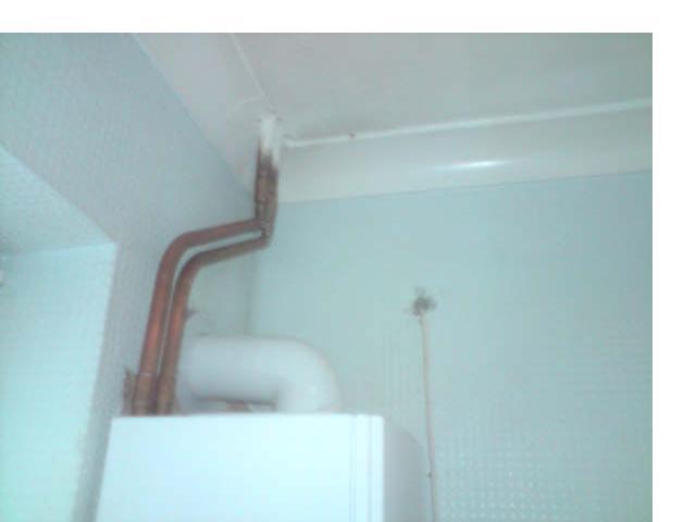

It's a very long story, but eventually, I had Vaillant send an Engineer to 'inspect' the installation. Several things he picked up on -
The 'flow and return pipes' were the wrong way round
Compression fittings should have been used to connect the pipework not soldered fittings
The gas inlet pressure only 15mbar when boiler operates at max recorded 20mbar at meter gas supply pipe restricted/undersized...
Today, the original installers returned to rectify the flow and return pipes.
They didn't do anything else.
The code F23 kept showing and they admitted they didn't know what they could do :eek: and as they had another job to go onto they left...

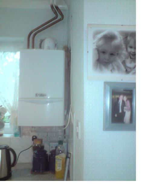

One other little thing that has me a bit worred, is the wiring that goes into the boiler. It appears to be hanging very loose. The bottom grill of the boiler isn't able to be fitted because the wiring is in the way. I'm attaching a pic...I hope I am anyhow...
If they have refused to upsize the gas supply pipe then ask CORGI to come and inspect it. If they agree then they will serve a defect rectification notice and they will have to do it at their cost!
