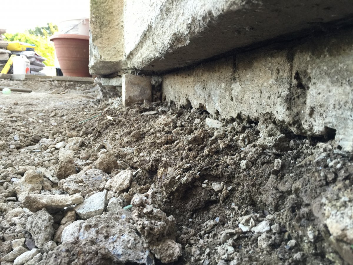

Thanks for the reply.

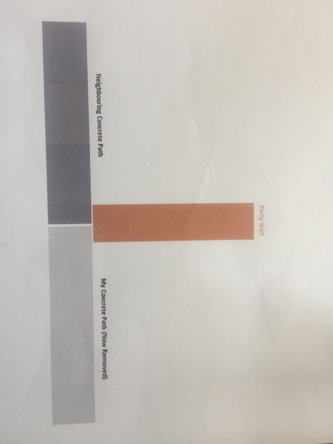

The concrete it sat on wasn't very thick, 3-4".
I stihl sawed as close as I could then used a breaker to break it all up.
The wall is structurally sound, although I had planned to underpin it with concrete when the footings were poured and then all would have been great.
The problem been is, this guy didn't even give me the opportunity to speak as he is intent on claiming cash off me.
I know this because he's done it before to other people at every opportunity. He really is a nightmare unfortunately.
Should I serve another party wall notice with my intentions to underpin? I'm thinking I can at least show willing to make good?

Legally speaking your neighbour is only able to claim damages from you and there hasn't been any real damage as yet. I think the worry is you could possibly end up having to pay his surveyor bill, which could be way more than any damage caused so far.
I hope you can sort it just don't let it esculate as you both lose and only the lawyers/surveyors win.
Perhaps you can use the sewer issue to tell your neighbour work has stopped for a while and you try to defuse it with him. People often say they have gone to their solicitor when they haven't, there still might be time to defuse it as best you can.
That photo of the path edge would seem to confirm that the boundary is in the centre of the properties and that the wall is a party fence wall. Without any further details within the deeds to the contrary, that would be the conclusion if it got looked at formally.
So the OP could proceed on that basis either using the PWA to demolish and raise a new wall, or building just on his side of the boundary (and face of that wall).
Remember that if the neighbour chooses to take legal action, it is his burden to prove he is correct. He will incur all the costs in trying to do so personally, whilst your home insurers would cover yours in refuting the claim. The courts do not look favourably on trifling claims.

I've lost track of what the OP is trying to do.
I thought it was building a new wall inside the boundary not touching the party fence/wall. Which would have been fine.
Now the OP has started work on the party fence/wall by removing half the foundation with a breaker seriously undermining the wall. This is going to get expensive. If the neighbour is as awkward as they claim this would be a good time to serve an injunction.
