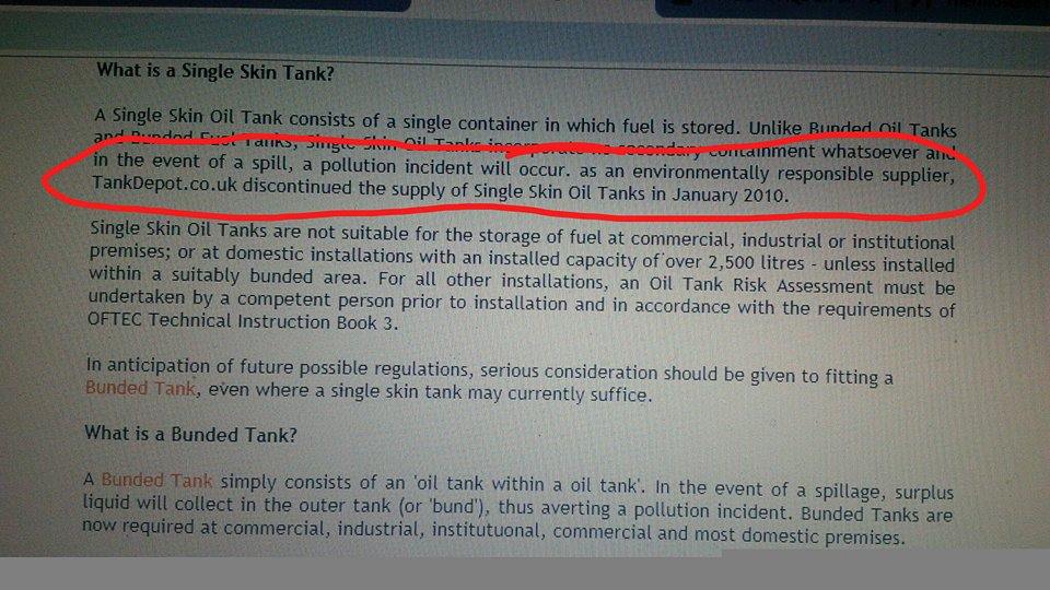

As far as I'm aware its illegal. You need to have a bund to catch the contents of tank if it were to leak.
Have a read here:
http://www.tankdepot.co.uk/faq.htm#Bookmark1

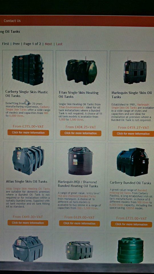

im aware that this is a very old thread but i laughed when i came across this.
